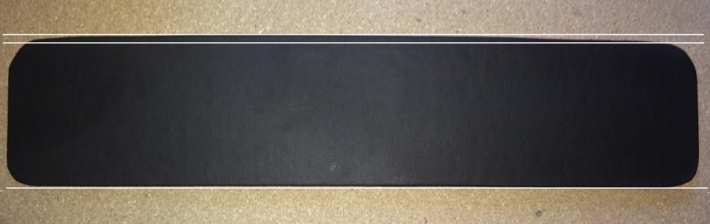

Postby paulheritage » 13 Apr 2014 17:55
This is the rear parcel shelf cover from TEF 89R.
The lines on it are to help describe the size as the bottom is straight but the top curved.
The height in the middle is 216mm, and near the ends before the curve it is 206 mm, so a 1cm drop (shown as the difference between the lines).
The width is an even 971mm, before the curves.
This shelf is made of hardboard which appears to be 10mm inc. the vinyl, so probably 8mm board?
