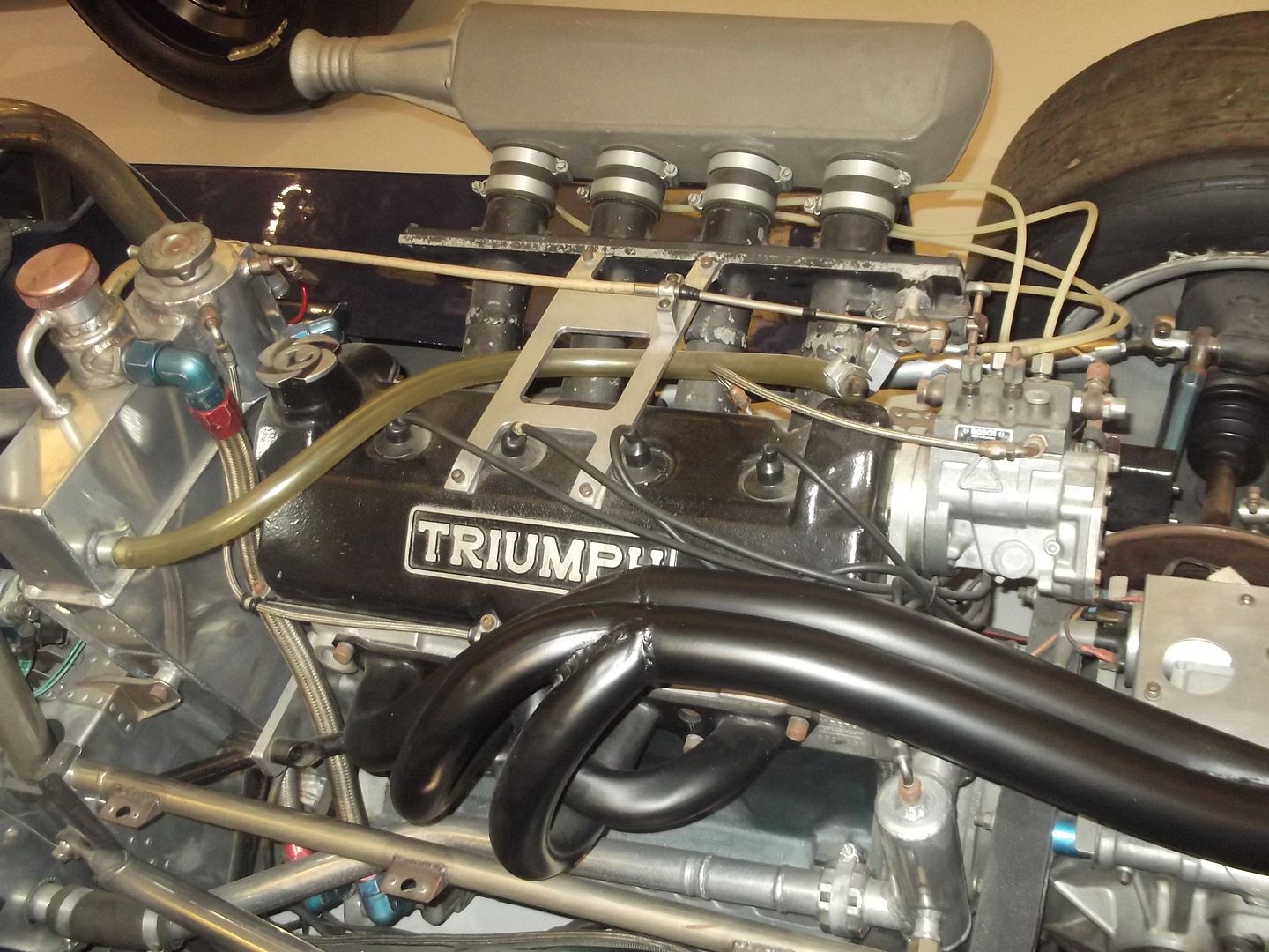

Here's another interesting company:
http://www.extrudabody.com/servlet/the- ... win/Detail
since you already have a factory FI system...you'll won't need the IFBs...but if you used a Sprint intake manifold with dual Weber bolt pattern...you could use the 4 IFBs...and that would look very cool.
