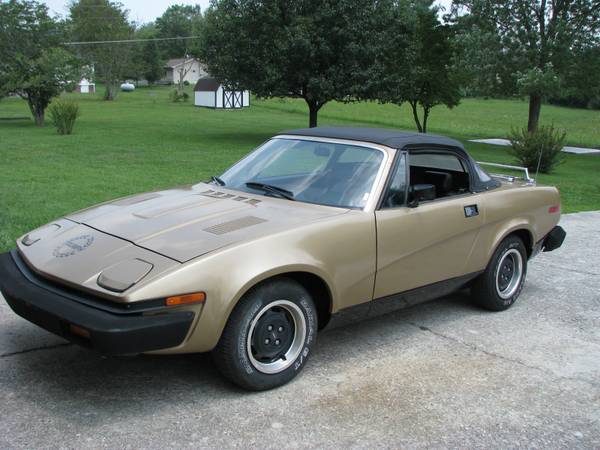

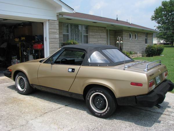

thanks guys. yup. i am in the states, eastern Tennessee. we have a lot of fun twisty roads here. i think this girl will be alot of fun. she feels rather different than my MGB...not better, just different. the 7 definitely feels more modern, that i'll grant you. anyway, she is an '80 drophead. she seems to be pretty original (other than wear parts--tires, belts, hoses, floorboards). i will see if i can figure out how to drop in a couple of pics. (these are the pics that the seller used in the online listings, fyi.)

She looks very nice james
That black hood sets off the gold nicely
Im having a black hood fitted next week to my light blue metallic
Brian

yeah, if you had told me "gold and black car" i would have cringed, but the gold is somewhat understated, it looks good together. i drove it about 45 miles today and i have the same amount home later. so far i am impressed. (my other daily...my BGT...is a great car, but it is definitely more of antique....the 7 is more modern.)
