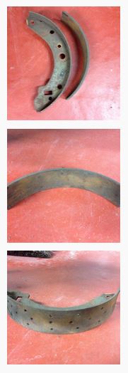

If you were to pull it up as much as poss?
I recently replaced the rear shoes on my 7V8 since one of linings fell off :o during my pre mot check.
The new shoes have as much meat on them as the ones I replaced which had about 10k miles on them. The handbrake with maximum adjustment (stretched) engaged fully at 5 to 6 clicks. The new shoes go to 10 clicks meaning I'll have to fit a new handbrake cable. Everything is fitted correctly and moves as it should.
