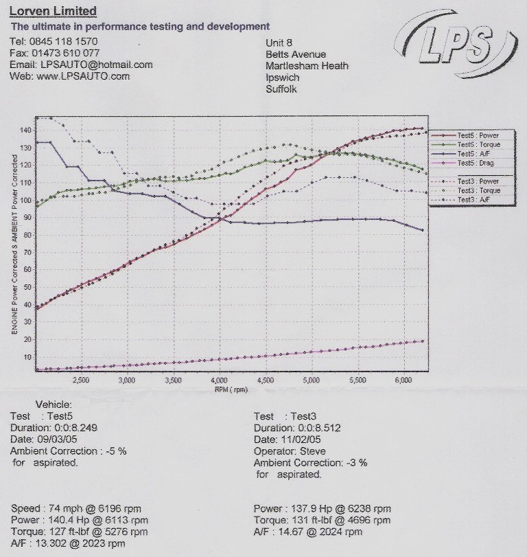

My TR7 16V only got 140bhp with twin SUs and this was with a DIY ECU called megajolt lite jnr.:
My TR7 16V power run:
