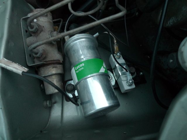

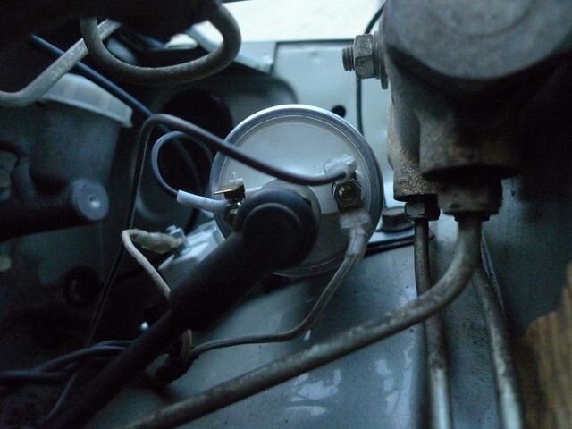

Fitted new resistor and coil.
12v white to one side of resistor
other side of resistor to + on coil
slate / grey and dizzy cable to -ve on coil
Hope this is OK.ImageImage
sonscar
Posts: 488
Joined: 02 Jun 2013 16:09
Re: ballast resistor question
Postby sonscar » 09 Aug 2015 22:26
On the ballast system usually fitted there is 12volts applied to the coil during cranking to help provide a better spark.This is via a relay and associated wiring which bypasses the resistor wire which is part of the loom.If starting from scratch without this wiring already existing I would most likely just used a 12volt coil and wired accordingly.Just my opinion mind as a 6volt system has some merits.Steve..
