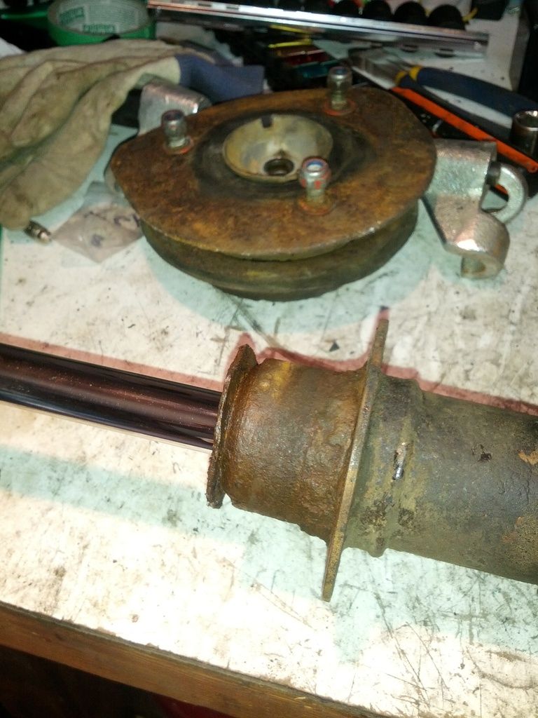

Anyone got any suggestions for this?
Both of them are rusted as h*ll. I've been soaking them for a couple of days in penetrating oil and tried removing them with a bar about 18" long. I'm worried about rounding the nut. Any tricks with this?

Lots of heat on the strut tube.

Oh my gosh that looks well in there. I have not seen one that bad before. Good luck with that.
I alos think that heat is the way to go.

If you are renewing the inserts you will get new nuts.There may be I staked dimple to drill out that secures the existing nut and you get new nuts with the inserts(usually).Secure the tube and use large hammer and chisel to remove.Good fettling,Steve...

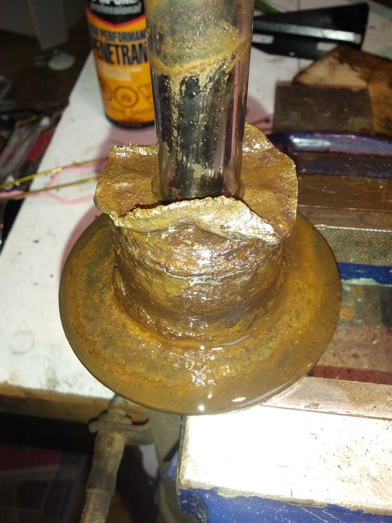

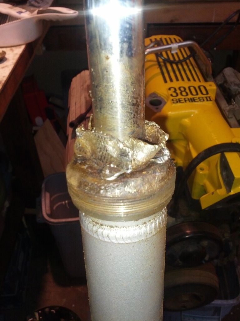

Well, success of a sort. FI Spyder was right. Perseverance was key. After the nut failed, I mangled it as tight as I could get it in my vise and then used a 5ft piece of pipe over a pipe wrench to give me more torque. Plus heat and freezing.
The carnage:

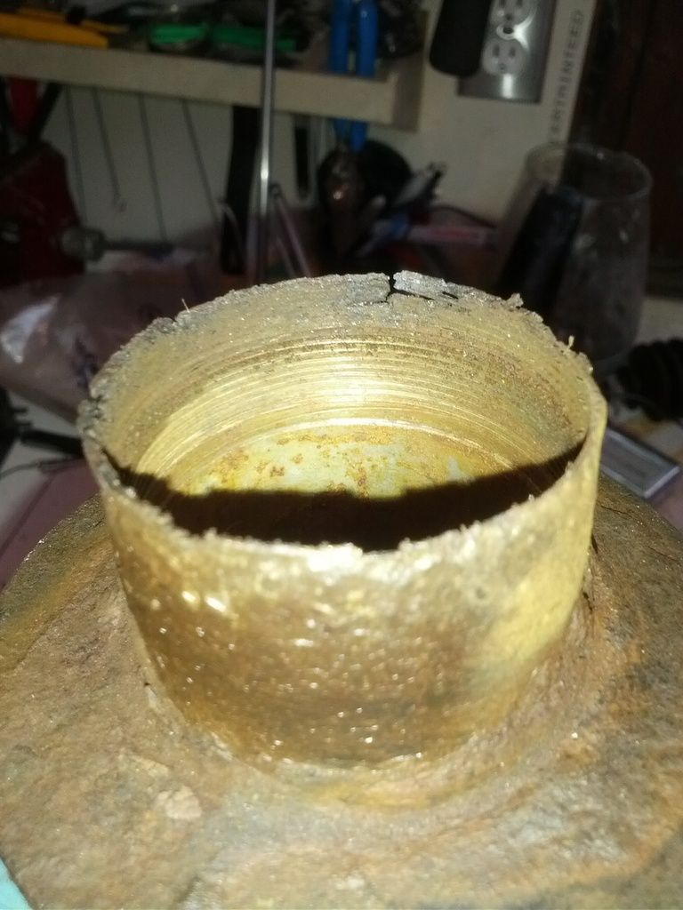

And the end result:

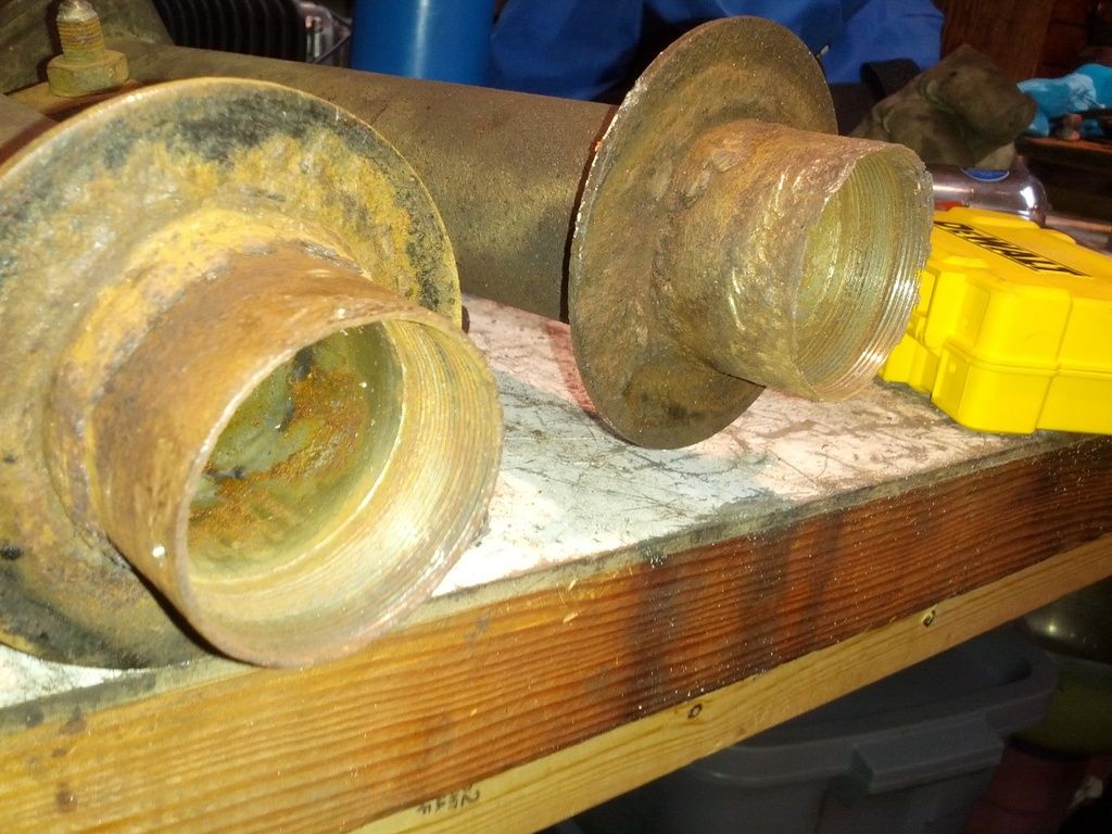

Victory of sorts, as I'm none too happy with the state of the threads. The other tube was not quite as bad, and I was able to locate the dimple before starting work.
Any opinions or suggestions? Are these still useable? I am new to this part of the car.
Re: Strut insert removal advice
Postby FI Spyder » 23 Jul 2015 00:11
I wouldn't. I would get a set from a car that is being parted/wrecked. Even though the car may be rotted out the struts will be good (your situation not withstanding).
