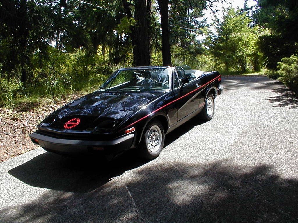

Postby FI Spyder » 09 Apr 2015 13:24
Mat I wire brush polish all the parts of the shoes & the self adjustment mechanism when first installing then after a rebuild, then lubricate everything with graphite powder as they go in. My self adjusters are still working fine after over 10 years, & 70,000 kilometers.
I basically have the same experience. In the first winter I had disassembled the whole brake system, readying it for our foreign import (USA) safety check. All rear interior brake parts were cleaned and touching/moving parts were lightly lubed with a brake grease (it's a very thick, grey, high temp grease that won't migrate). The brakes shoes looked good as were reused as a slight weeping from the brake cylinders hadn't reached them. I used new cylinders as they were cheap, I had them in stock and time was becoming of the essence so didn't want to order rebuild kits and do them that way. Any moving surface was cleaned and lubed in the handbrake to activating levers. A new rubber cover for under car hand break mechanism as it was missing (as were most rubber parts on the car). It was adjusted to spec in the OEM manual. It holds the car on my steep driveway while I get out to put ramps under the front tires to change oil etc. but does need some muscle to ensure I have maximum holding power.
As an aside, I had adjusted my Tercel rear brakes to were I usually do (like them) and found I had worn out the rear drums. I looked in the manual and found they need 6 clicks not the 3 I usually like. Something unique to that car. Our car isn't like that.
I think I used the usual procedure (I think it's in the OEM manual) to do the rough adjustment of break shoes after the drums are on but it was 8 years ago and I have trouble remembering what I had for breakfast this morning.
Shot of car on steep driveway to show what it will hold on.
