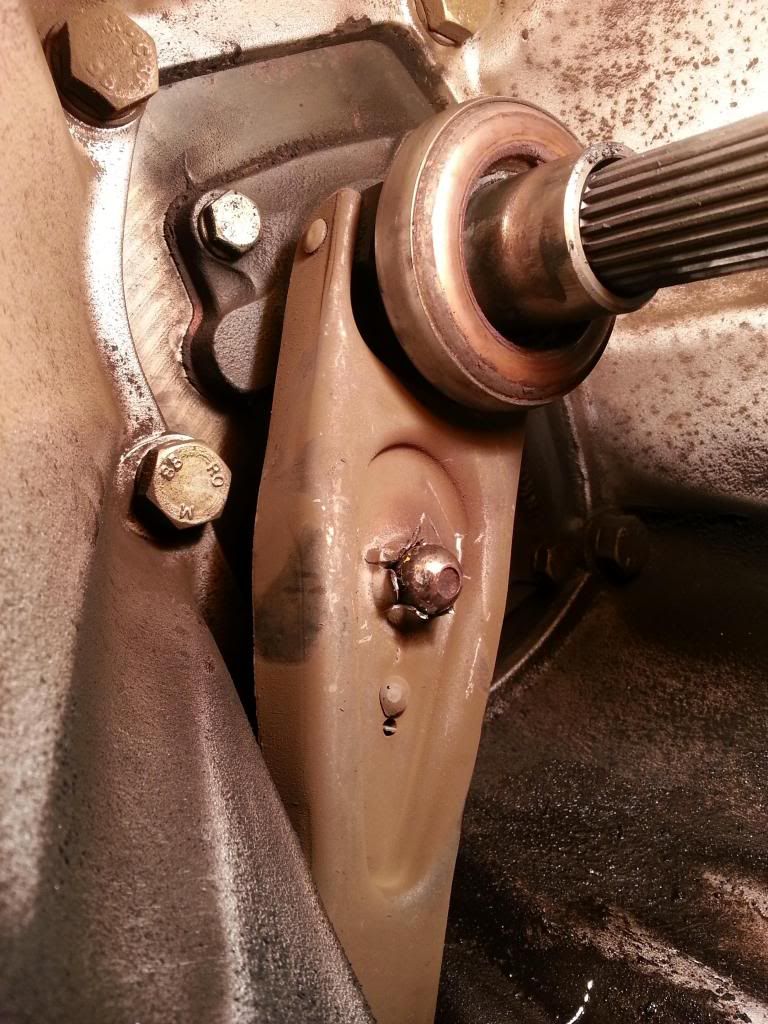

Postby whitenviro » 28 Mar 2015 01:49
Yes, it does sound like this may be your problem:
Image[/URL]
Or it could be the slave cylinder rod pushed through at the other end of the fork, but the problem and solution are the same. First take off the slave cylinder and get a peek inside the bell housing. Chances are, you will be getting a good look at it later.
Use it as an opportunity to replace the clutch, pressure plate and throw out bearing. Check the bearing carrier for wear and replace the slipper pads that the fork holds onto. While the gear box is out, replace the shifter bushings and drain and replace the fluid with syncromesh. Get a reinforced fork, rebuild the slave cylinder and install a braided clutch hose while you are at it.
It only took me eight months. But after having done it once, I'm sure I could cut that time in half if it ever happened again!
[/img]
Postby busheytrader » 28 Mar 2015 06:41
That photo shows exactly what happened to mine. Great photo..........
The metal on my. Clutch fork had worn through to paper thin and eventually the pin / fulcrum punched it's way through.
As per all the contributions it's worth checking out the whole clutch when the fork is replaced. You don't want to go through the whole operation again soon afterwards.
