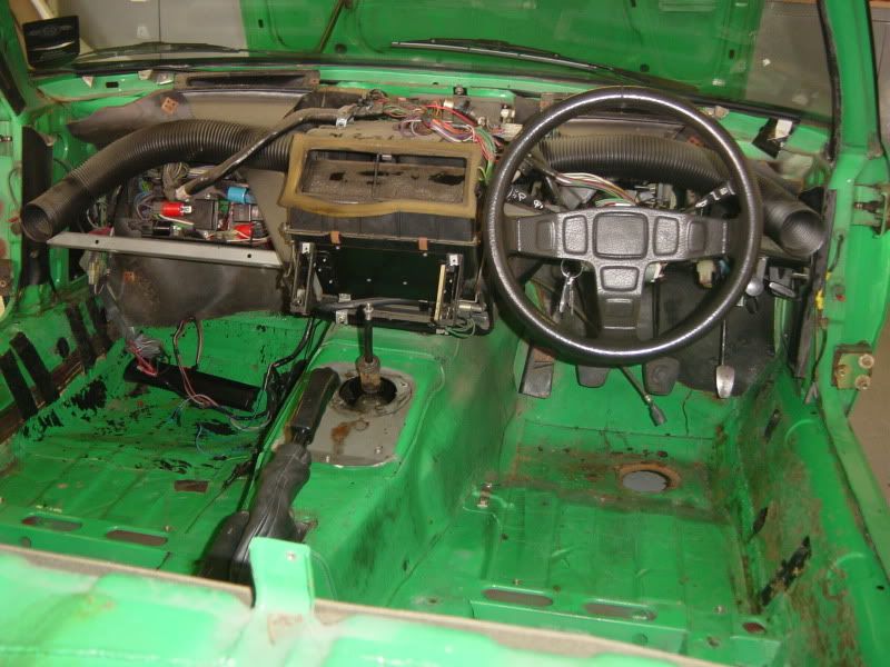

Well I started to strip the TR today ready for resto,repaint and V8 conversion. Taking it easy, photographing and bagging/labelling as I go. Been doing concours restos on cars for almost 15 years and it pays to take it easy and keep a track of parts, make a list of items needed as you go along, for example if you break a fastener taking something off [:I][:I]

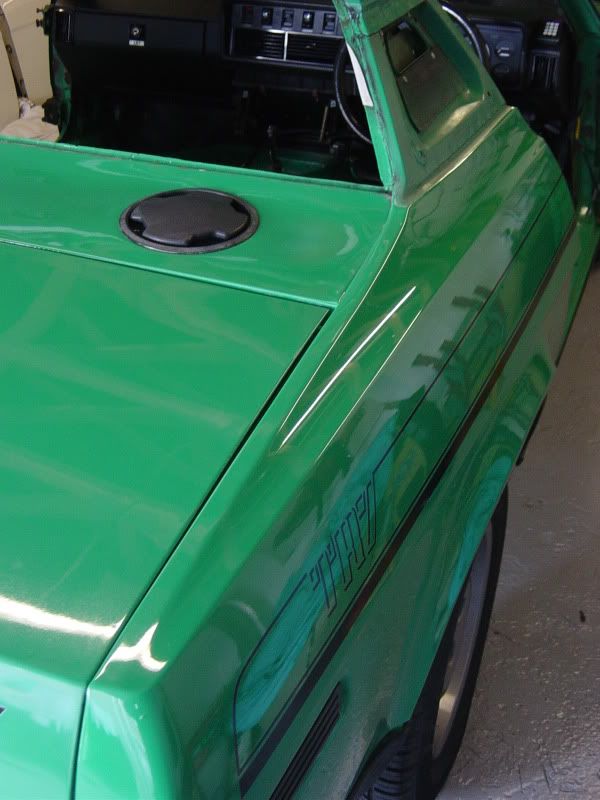

A few pics, happy for your comments, popped one of the floor bungs mentioned in another thread on the board, mine also are just large flat discs, no pressing as such like a proper floor bung.

Postby Rich in Vancouver » 30 May 2009 18:37
That looks like a nice solid car.
How early is it?

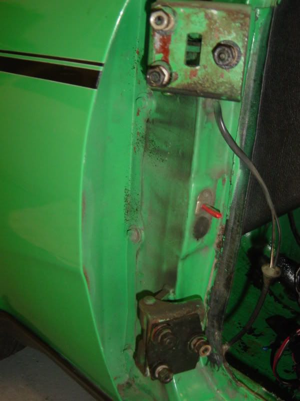

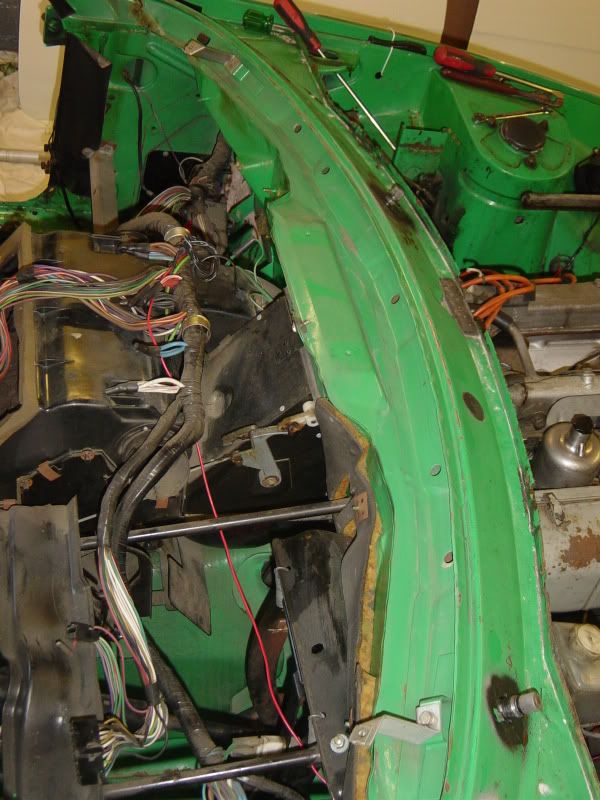

So, while the rest of the family sunbathed I carried on with the strip down, todays job was dash removal ([:(!] sheer bolts on ignition[:(!]),front screen out, in one piece, bonnet off and roof lining out. Not a lot but I was in and out watching the MotoGP, British Superbikes and now looking forward to World Superbikes tonight [:D]
Been inspecting up inside the front wings the best I can, unsure whether to have them off just to check 100% or not.
cheers, Paul
<font size="2">Happy to report no issues around screen aperture</font id="size2">

Good to see the pictures with the dash out.I have this job to do to sort out some electrical woes and it is not the mega wire forest i expected to see.You have been busy ripping into the car kep up the good work.Are you replacing the removed parts with new ones or just making sure all is ok? Also what is the problem with the red donor? Why not resore that with the engine already in? Just wondered as a shame to see any TR die[8)]

Will be fitting all new bushes, adjustable suspension, new brakes right round, V8 engine will get stripped and overhauled, gearbox will maybe be exchanged for a recon'd unit although I have driven it and it seemed ok, rear axle will be stripped and fully rebuilt.This is the last resto I am doing for myself so its gonna be right and done to my requirements.
