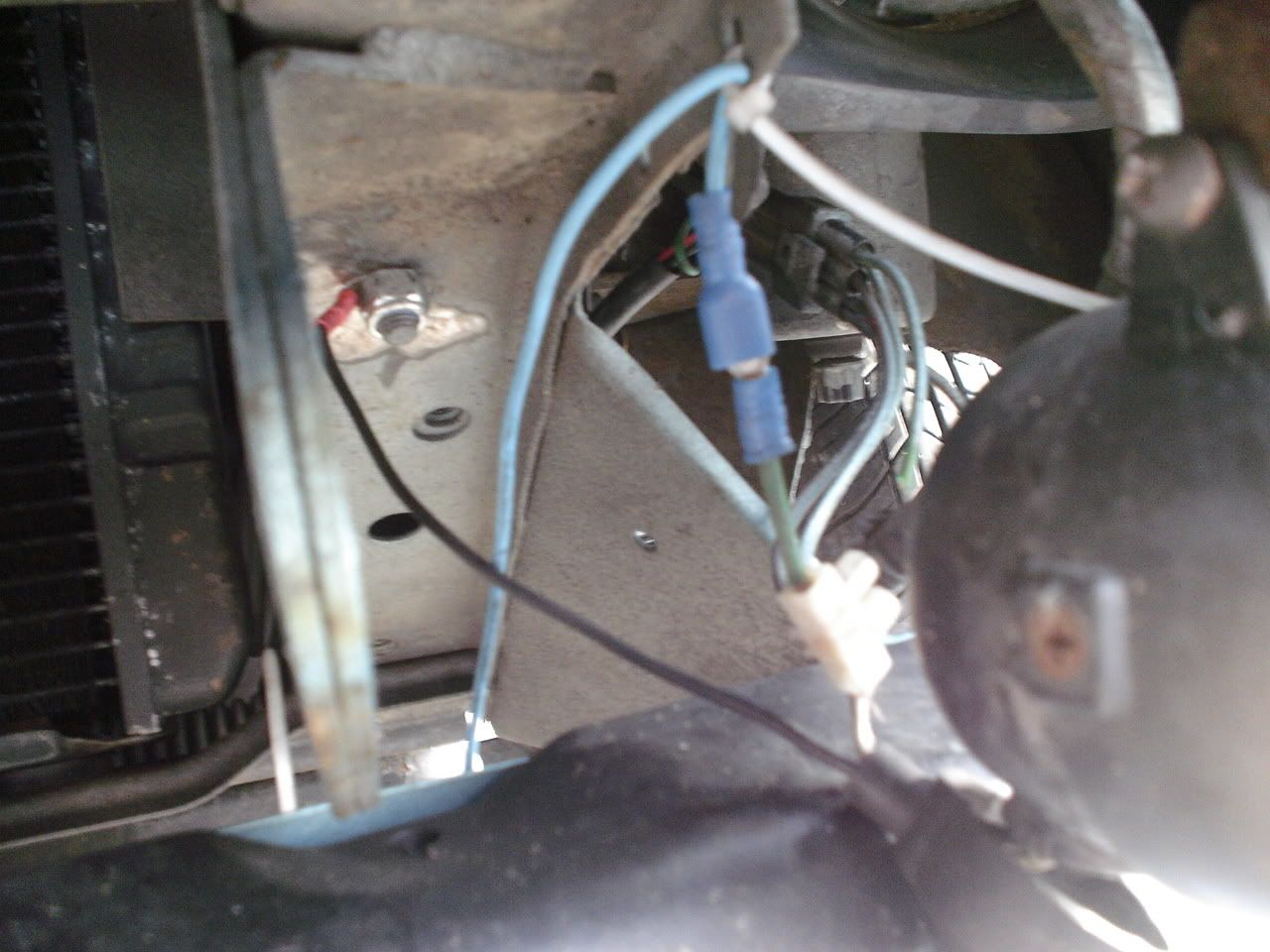

Checking the lights last night I noticed the front fogs not working at all, so I investigated closer. To say that I was annoyed with what I found would be an understatement.
Here is a picture of what I found at the R/H light. Firstly is a new earth. Well ok, I can live with that. Then there is a block connector where, if I remember correctly, there was a bullet connector, and the feed wire has been cut next to this block connector and crimp on spades fitted (why not just wire into the block connector?) and a new, blue wire disappearing across the top of the spoiler. The cut wire from the main block connector is just left hanging.

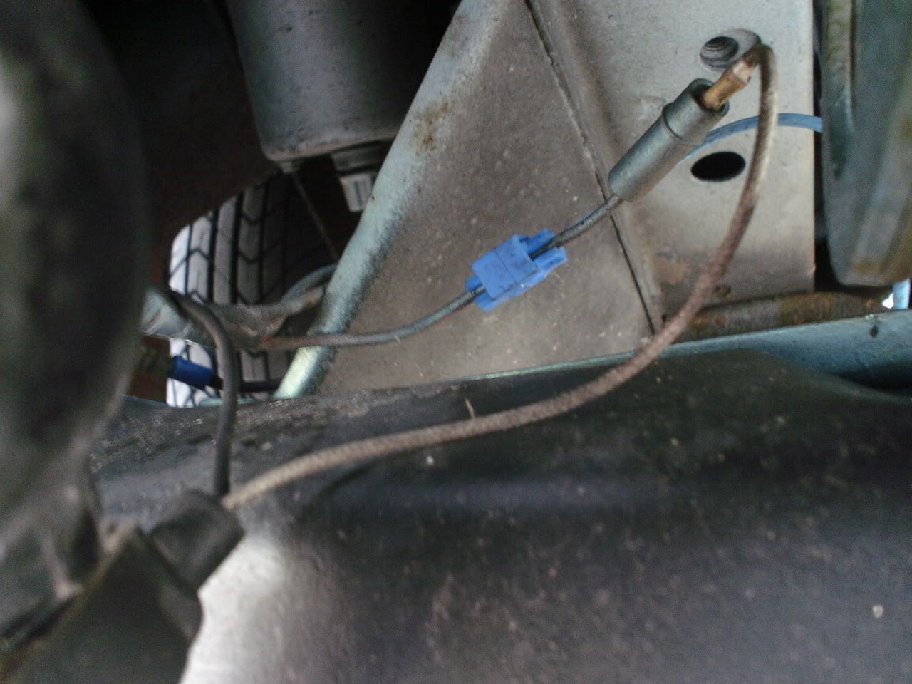

So I followed this blue wire and I am sure you can all guess that it went to the L/H foglight. Would you like to see the professional wiring? Ok then.
I think the moral of this story is do it yourself if you can. So called professionals can be worse than useless.

I love the sight of Scotchlocks in the morning!
