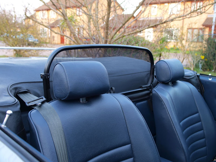

I do have the "BMW" screen fitted to my car.
I can give you dimensions if you wish.
I prefer the mesh type as having tried the perspex one the air cannot filter through it so it can buffet about. where as the mesh one can diffuse the air far better (in my opinion )
And the scrren does not have to be any taller as it's only restricting the air that is swirling back into the car from the windscreen.

Postby TR Tony » 20 Mar 2009 19:45
That's exactly what I had in my DHC. Like Wedggie, I was pleased with the improvement it made.
Good picture too - I think you can see how the screen sits in relation to the rear deck so might well fit with a roll bar in place.
