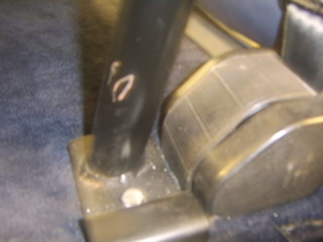

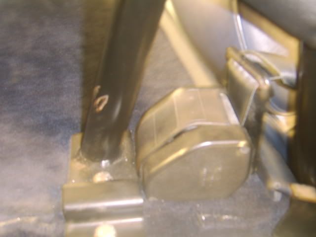

Postby john 215 » 10 Mar 2009 20:12
Hi John,
Pictures of behind the seat belt reel
And
Sorry about poor quality but bl88dy freezing out there tonight!!
Hope this helps,

Postby DJV » 11 Mar 2009 17:55
John,
Your right, pictures save a lot of words, and these answer my question.
