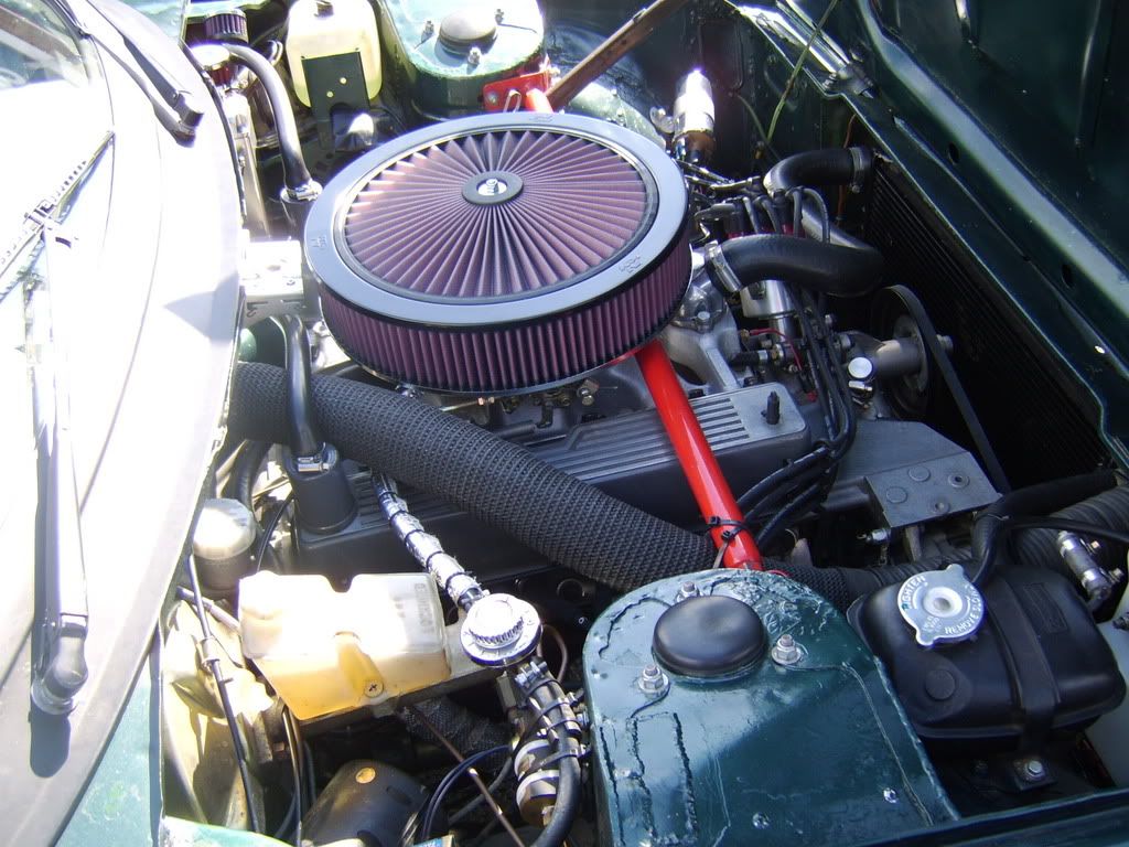

Postby paul w » 06 Feb 2009 22:30
Saw this v8 with the bar thingy at Malvern last year-

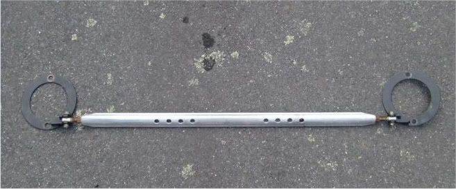

Postby PeterTR7V8 » 06 Feb 2009 23:26
This is the kind of thing I'm looking at...

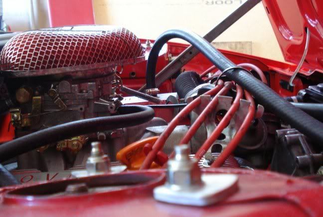

Phil (Chunk) has a universal one i beleive.
Under bonnet shot of Phils 'old car'
I would think it has to help with a DHC, after fitting a rool over bar in the back of my DHC it felt more rigid so front must help.
The spoiler on that race car looks like a MG Montego boot spoiler, a direct fit, no cutting fits straight on and IMHO the best looking of the options
