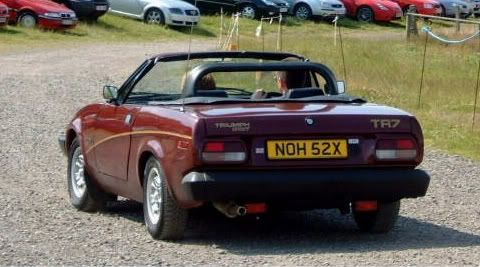

Postby PeterTR7V8 » 06 Feb 2009 02:30
There are several different designs to choose from. The picture below is the most handsome type in my opinion. Rimmers sell the Aley style hoop which is similar once you upholster it.

Postby Underdog » 06 Feb 2009 02:44
I have a Kirk Racing bar. Top stows fine. The cover fits as well but the diagonals interfere with it a bit. I just tuck the front flap down between them and the rear bulkhead. With the top up, the one bow barely clears the rollbar hoop. This is OK with me as I want the maximum hieght above my head & still be able to use the top. I also had to bend the shoulder harness brkts somewhat to clear. I lost a bit of rearward seat travel but not a problem for me and I'm near 6ft tall. Be aware you will need to drop the gas tank to install. I'd probably say that unless you have a good reason, it's not worth the hassle. My reason is track days. Converts have to have one.
