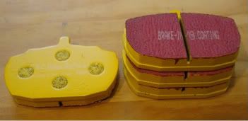

I got my new EBC Yellow Stuff brake pads today. They give off a strange rubbery smell. I might have to get some yellow brake paint to match. I probably should have gone with red but I'll see how these go first.
