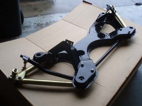

TR7 FRONT SUSPENSION TRIUMPH ROVER SPARES HAVE A NEW SET UP FOR THE FRONT SUSPENSION SORRY CAN'T SEEM TO GET THE LINK LOOK ON THERE SITE UNDER TR7/8

Saw this set-up and would definately like to have it on my car - but that will have to wait for the budget appraisal - probably go on the <i>'to do in the future'</i> list!? (will be a <b>BIG </b> list I reckon ............ )

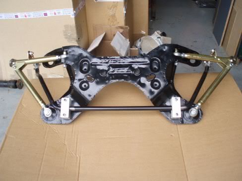

That's more or less a straight copy albeit a little more modern of Grinnalls front wishbone conversion set up that the Ramestein cars had.

why to use spherical bearing on a road car?
you'll knock all of your kidney stones away :)
+ spherical joints are expensive compared to rubber or poly bushes

Do not think it is really aimed at the road car market - more the competition stuff!

There's also the TR7 race front suspension that's listed on the site. That one's "only" $1,950 and looks like a broadly similar concept. Wonder what makes it worth twice the amount...

The sway bar is different.

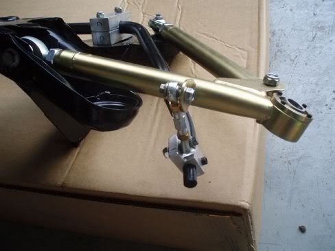

I'd say the piccies show the race suspension as the orientation of the spherical joints at the front of the tension struts won't allow for much suspension travel.
<font color="navy"><i>Edit - just back from a visit to a friend who's building a Rally Escort Mk2, so could try it out. With the bolt for the spherical joints vertically there should be a total suspension travel of between 100-150mm (depending on strut length). Enough for a circuit or tarmac racer. But unsuitable for most of the tarmac/gravel tracks we have over here. So I would locate them with the mounting bolt horizontal (call it personal preference [:I])</i></font id="navy">

Good to see I'm not the only one that thinks the swaybar locating system of the OE suspension is a weak point. Just wish I had a bucket of cash to buy that setup.[:(]
