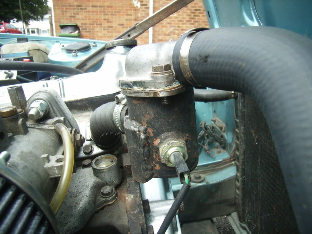

Hi Alex79, I fitted a set of Dell'orto's to my 8valve which are now on my Sprint engine. I think the photo you need is:-
Let me know if you need any others. The unit actually bolts to the place where the front lifting eye was.

Ngtf, is that a home made piece?

Postby ngtf » 09 Dec 2008 21:30
Hi Alex, yes it is homemade but does the job superbly well. A simple piece of metal welded in place solves the problem. Using existing mounting holes (in my case the lifting eye) made it simpler still especially when you bear in mind, I even used the original lifting eye mounting bolts. The eye has been kept for future "out of body" experiences. Note also the blanking plug (core plug) fitted to what was the spigot from water pump top cover to manifold. This was a core plug that is still in use today in the MX5 (Miata?)

Postby alex79 » 09 Dec 2008 21:47
Thanks Ngtf, I didn’t notice the pug on the pump until you mentioned it. I totally forgot that the pump connects to the manifold there! If you can get more pics, I could definitely use them. Now that I’m looking more, I noticed that you do not have a stock thermo outlet. How do you fill with coolant? Comparing it to Omichaelshar’s pic, the radiator hoses look different, or its just the pic. Do you have the large hose going to the right side too, or is it on the left side?

Postby ngtf » 09 Dec 2008 22:31
Actually <b>it is</b> a stock unit. There were differences between early and late TR7's. Mine is definately a late fitment with no bleed valve on top. Omichaelshar's is the early one. If you need the early one just weld a bracket to that instead, it matters not which style you have as long as the one you modify and fit is the one you need.
PM me an email address and I will send whatever photo's I can of my installation.
