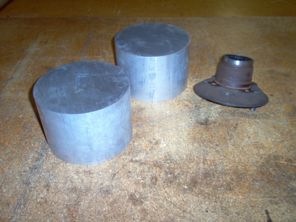

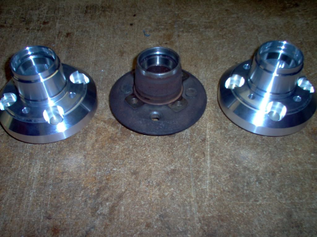

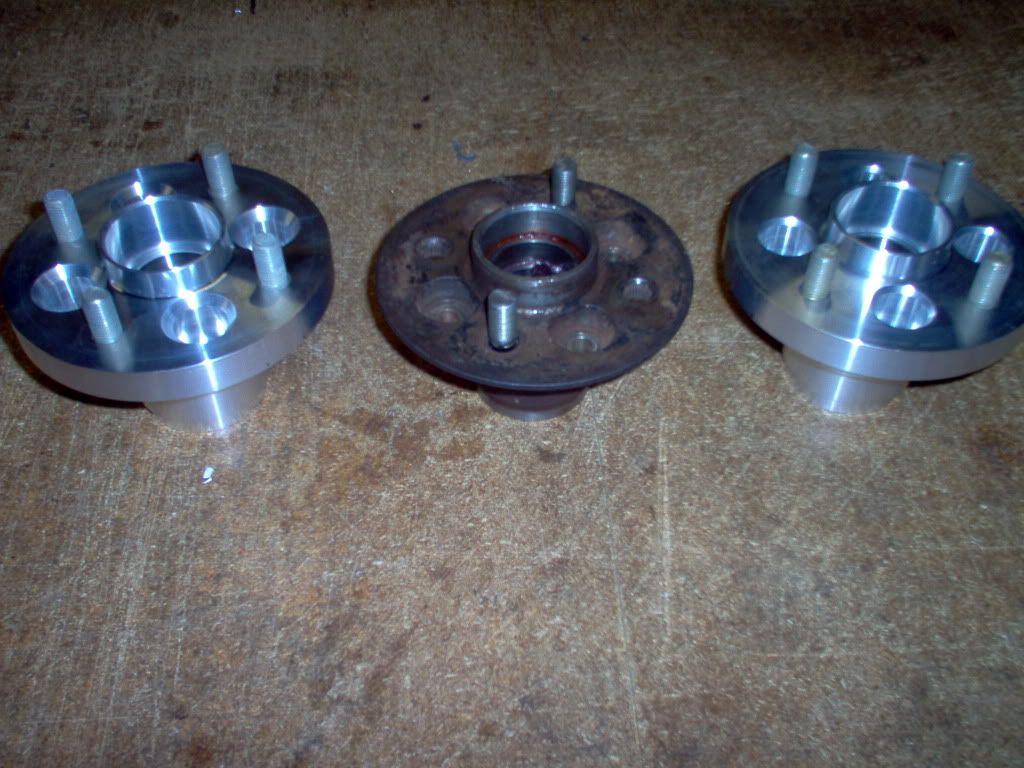

The Wedge Shop was recently exploring the possibility of producing alum front wheel hubs. There are so many improvements that can be made to them, I decided to make my own set. Here is a picture before they went on the car:Image

They look good!
What improvements did you make?

These weigh only half as much as iron but are stronger. This reduces the unsprung and rotating weight. The stud pattern is changed to 4 x 100mm. The outside bearing is larger. The front track is reduced which allows me to use wider tires with no rubbing. The wheel center holes are slip fit to the hubs. Minimal corrosion.
That is all I can think of at this moment.
Randall

Randall, The new hubs look great and the weight savings has got to be an improvement. Have yhou had a chance to run the new hubs on the car yet? How have they performed? Have they made a difference in handling? Any report you have will ber helpful.

The (lack of)preload on the bearings has been one of my motivating factors for using larger bearings. My guess would be that larger bearings would allow less looseness in the setup. So my bearings are less loose that original setup, and they seem to be OK after 2 or 3 thousand miles. My front wheels seem more solid than with the original hubs. However this may be the result of more precision machining or stronger hubs. I used 7075 alloy which is as strong as steel, but 1/3 as dense.
Also note that I decided to create dual bolt pattern for my rear wheels. I mounted my rear wheels on a milling machine and drilled the extra 3.75" hole pattern. You cannot see the extra holes under my hubcaps. I am using BBS 14 X 6 on the front, and BBS 15 x 7 wheels on the rear. The BBS wheels have more offset which narrowed my rear track and allowed 225 wide tires with no rubbing at all. The overall front & rear track is about the same as original with wider tires. The front has to not touch the struts or rub the fenders when you are turning.
