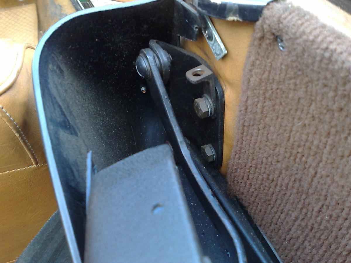

Postby Philip » 08 Sep 2008 05:30
I checked on the car today. The rear J clamps fit into brckats that are bolted onto the hood hinges using the top hinge mounting bolt.

Postby Philip » 08 Sep 2008 05:45

Phillip
I have one just like yours man, Poseidon Green and Beige,Nice.
I was not to happy with it when I got it, i like it now. The combination is great.
The only thing is that you have the steering wheel on the wrong side Brother!!!!
Do you have pics as clear as the one you just posted on the Hardtop itself???
you know the inside
The hooks
The seals.ETc.
I know its alot to ask,But if you have them??
Take some pics of your car with The top.
