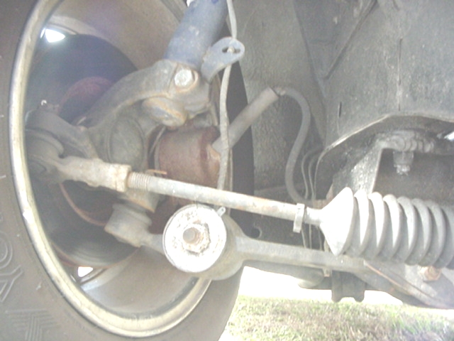

<b>Mustang II front suspension </b> I have looked through the archives searching for  anyone who may have adapted a M2 suspension to a TR 7/8. Has anyone looked into this arrangement?  Is it feasable and not a case of how much money do you have to throw at it to make it work??        Cliff
Postby jclay (RIP 2018) » 20 May 2008 01:34
Cliff,
With enough money, you can make anything work. The question is WHY?
I can understand why all of the hot rodders put these M2 units under the old Fords with there straight axles, but the MacPherson strut is a modern design used in many great car today.
With modern up-grades such as Poly bushings, gas shocks, roller or ball bearing kits, anti-dive plates and strut tower braces, the Triumph front end is one of the best around. You can even so as far as coil over springs and adjustable tower toppers.
Put your money in your engine or a college fund for your kids.
Have fun, drive fast & safe, be kewl,

Just for the record, to the best of my knowledge, a Mustang II (M2) also utilises a McPherson style frt suspension.......
but Cliff, I am also mystified why anyone would want to go through the effort to adapt this of a wedge????
Planing on swaping over some kind of Ford engine w/powertrain swap???

The double wishbone setup looks a lot like the aftermarket deal selling for the MGB. What would be really neat IMO is a crossmember with a true 3 point lower a-arm but retaining the strut suspension. That would eliminate the swaybar as a locating link which I think is the largest defect in the factory design.

Just my two cents worth...The M2 suspension will give more wheel options, more brake options, has countless upgrade parts available with more being designed all the time. Also because so many Hot Rods run them they are fairly easy to find and can be bought at a reasonable price from if you look. There are several universal install kits out there that should be able to be put on a Wedge easy enough. When I get around to the resto on my 7 I am thinking about the M2 suspension also so keep us posted.
