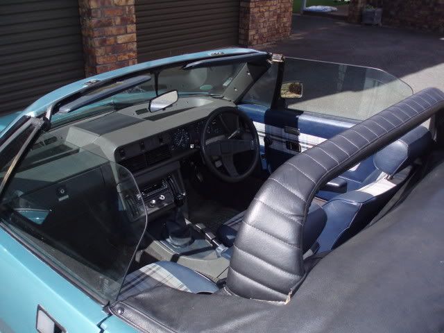

My DHC Grinnall has a annoying issue and that is a slight rattle from the side windows when the hood is down.
As you can just see, the qtr frames are a little worn.Is it just a metter of replacing the felt?
Is there a DIY fix for this bearing in mind TR parts are not too common here?
Otherwise, I love it!
Cheers, Jerry

Should be just a case of replacing the felts, one of the first jobs I did on mine, the windows rattled with the hood up or down.

Some times the felt just works it way out and falls to the bottom of the door. I lost mine.
My drivers side window would rattle and come out of the track, so I took of the door card and found the rear track laying on the bottom of the door. I removed the holding bracket, just one screw, and saw that the tack welds holding the bracket/track together had broken loose.
I drilled out holes in the bracket and the track where the tack welds had been and used pop-rivets to repair the unit. I could not find the felt, so I made a new one. This gets tricky, so I will try to make is simple.
I had some 1" wide sticky back smooth velcro, so I cut a piece that would fit in the bottom of the "U" track and worked that the whole length of the track. Then I took another length of smooth velcro and laid that into one side of the "U" track and then folded it back over the metal edge of the track. That left only one side of the "U" track as bare metal. I could tell that just laying in another velcro edge wouldn't hold the window in place, so I used some sticky back foam insulation material about 3/16" thick and 1/2' wide and laid that into the inside of the of the "U" track.
I then rolled the window all the way up, laid the top of the track into the the opening at the bottom of the window and remounted the track with the single screw, getting it as close to the original position as possible. Now there are four guides in which the window rollers ride. I used my little finger to work grease into those guides and then rolled the window down, and greased the other ends of the guides. I worked the window up and down several times and checked the guides again, add more grease as needed. Lastly, I worked a very small amount of oil into the new "Felt" I had made just enough to have the window slide easily in the track.
I put the door cards back on and test the window again. I noticed the next day that about 80% of the rattles in my car had gone away.

The felts are held in place by friction fit at least in the rear. The rear one usually falls out. As the felt gets worn over the years the window sits in there loosely. I've replaced mine and glued them in with rubber weatherseal glue (it's like a black contact cement.) Your rear window guide on the door may need replacing as well. My windows are now sit in the channel nice and firm and no way can they rattle at any setting.
I've also replaced the outer rubber seal on the door and the door card (which was warped at the curve by the lock knob. Yours look OK but if they are worn or hard mat contribute to a rattle.
