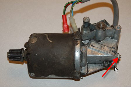

I had a rebuilt headlight motor assembly that squeaked and squawked when the motor ran. I had to open up the limit switch assembly and adjust the tension on the gears. If my memory serves, there is a tensioning screw on the motor case. It was a little loose on my motor assembly...a slight tightening and the noise went away. I'll try to remember to take some pictures and post them when I get home from work this evening.

Here is the adjustment screw.
The photos above show the adjustment screw. Simply loosen the set nut and adjust. You will most likely need to have the motor assembly removed from the car to accomplish this.
Take hold of the knob as in the picture below and try to pull it in and out to feel how much play there is. I removed all play from mine to eliminate the squeal.

Thats got to be the problem and your pictures are very helpful. I'll pull the assembly out and give it a try.
