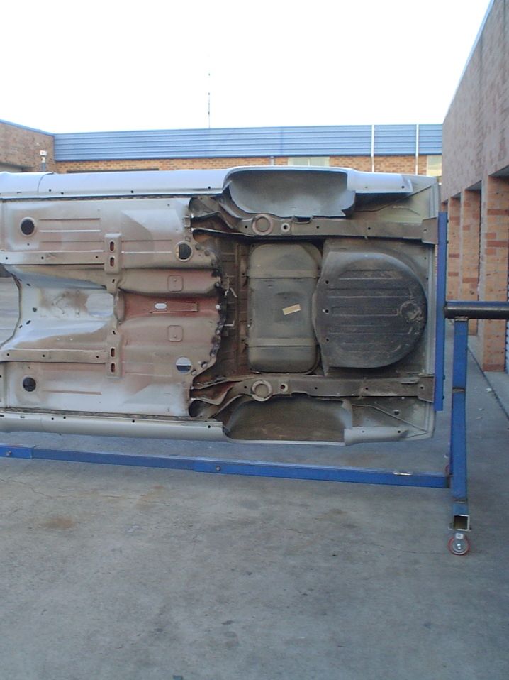

Hi All,
My car is now (intentionally) on its side with the entire rear suspension components and axle removed. I'm standing there staring at it and have hit a wall as it were, the plan was to strengthen the mounting points where the trailing arms meet but i can see so many spot welded seams and potential for strengthening that i've gotten a bit overwhelmed by it all. Add the fact it's remarkably solid under there and has never had any welding, it seems a shame to go to town on it if that makes sense, in fact i don't really know what is necessary for the state of tune it's going to be running.
The question is, what would you guys do in my position?

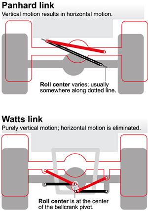

Why not fit a watts linkage rather than a panhard rod? Use the SD1 bits and pieces - diff backplate and links. A quick look on ebay shows that Land Rover Discoverys have similar items - ebay number 321839987055.
A simple graphic:

Hi Jeff,
I did look at that. I drew a blank at the diff casing It appears they're pretty rare. The standard diff pan doesn't appear strong enough to modify either. What's your thoughts?
There is an increase of time and cost of the watts vs panhard, are the benefits worth it? Considering the use the car will get.
Sorry i just saw the pic, the benefits are obvious now. Doh!

Whereas there is undoutably sideways motion with a panhard rod the diagram shows possibly the worst scenario.By making the rod as long as possible and mounting it horizontal at normal ride height the movement is lessened considerably.Just my observations after fitting one to my V8 MGB.Steve..

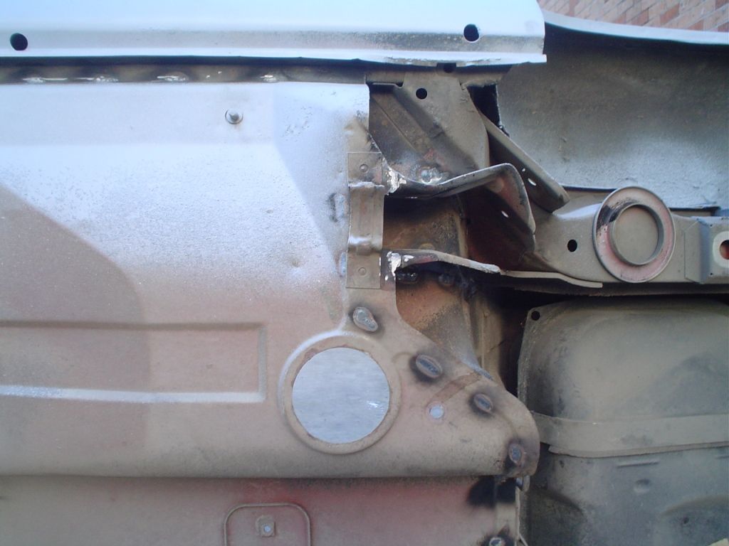

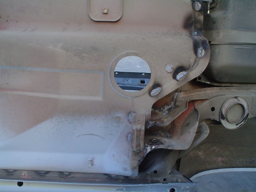

The picture below shows the welds recommended by a local expert that is very familiar with strengthening the rear suspension for V8 conversion.

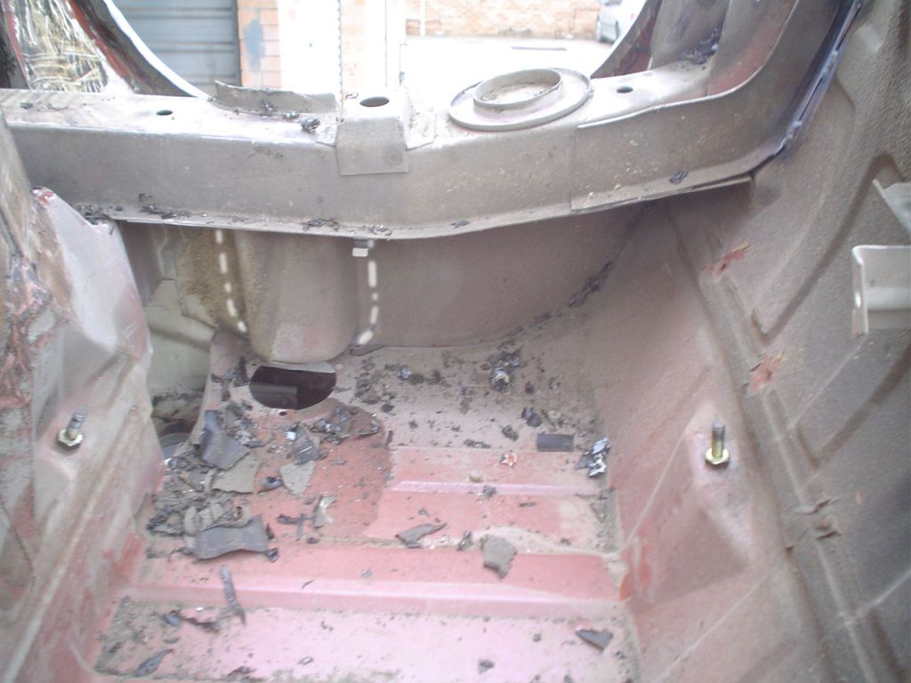

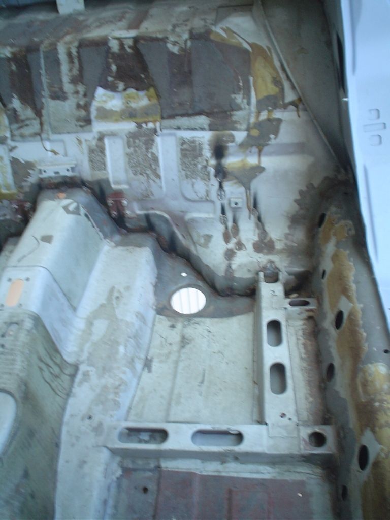

He did say that the welds shown in the first picture above would be sufficient, but I decided to also seam weld the floor pan as the interior was removed. The pictures below show the seam welding where the floor meets the rear bulkhead.

Those pictures are pure gold, thanks ever so much for posting. I've decided to go with the panhard rod because it offers the best bang for buck, even though the watts linkage does look the dogs! I really do appreciate all your help, i've now got a plan to work towards.
Re the brackets, can you copy the other side and fabricate one up? There are brackets for panhard rods on ebay, mostly listed for mk1&2 escorts, do they look similar to what you already have?
Thanks again,
Rob.
