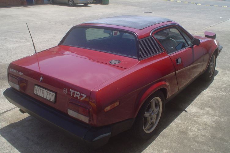

Hi there,
Your sunroof looks to be the Edrose which was used on some Speke built cars and (all I think) of the later built cars.
Like you, when I had it redone by an old school trimmer he made it very tight and I complained.
That was ten (10) years ago and I am now pleased he did it this way and agree with the rationale he gave at the time.
It is now easy to close, yet it still does not leak, being still tight down the edges.
The first few years it took muscle power to close properly... but I don't mind this given that I expect the vinyl to last at least another five (5) years.

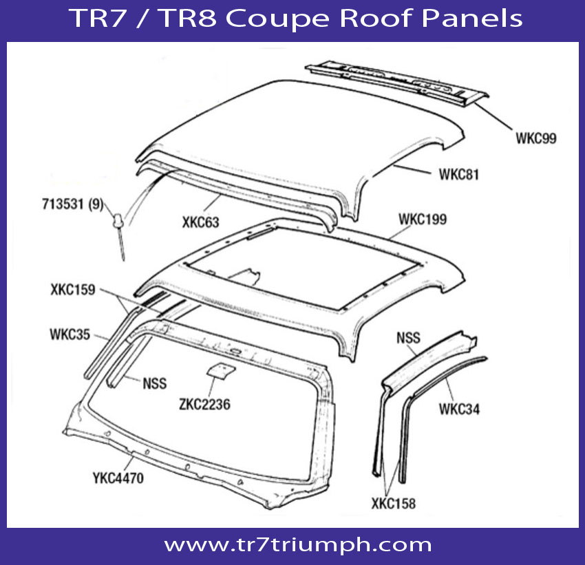

The steel Roof panel has only one part number (WKC199 / WKC 199) so clearly Edrose and Webasto fit the same hole. Maybe Webasto and Edrose are just a name change as one company purchased another?
The issue with re-covering them appears to be the welded seams you see across the exterior. All upholsterers in this small country can only stitch the seam. I would like to hear of someone who can provide a welded replacement.

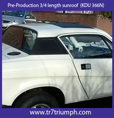

Also agree the two type fit into the factory frame, the only ones that don't were in the pre production sunroof, which were 3/4 size and fitted at the dealership.
