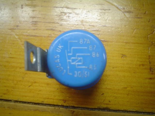

Postby Marsu » 26 Aug 2010 02:42
In my case it was a failed relay. The car started easily after replacement with a second hand unit. The new and replacement are both Lucas items:
The connections on the original were not corroded, but cleaning had no effect.
Postby bmcecosse » 26 Aug 2010 12:41
Is there any difference between the blue relay as above - and the black one with exactly the same connections ?
