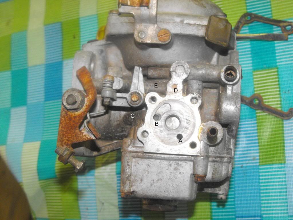

Question: If I can drill the hole from the semi-circular cut out through the runner into the carb throat like the earlier carbs and plug the other holes that were used by the FASD will the choke/carb work as is should or am I missing something?

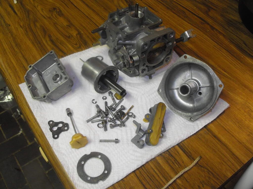

<font size="3">Oh, a gallon can of carb cleaner and an ultrasonic cleaner really cleans up a carb for the rebuild !!![:D](The plastic parts did NOT go in the cleaner...just some Dove dishwater soap)</font id="size3">

Ok Johnny, here we go.
Manual choke circuit: The fuel route when the choke is pulled on goes like this.
Fuel is drawn from bowl through hole A though the choke mechanism to hole B and then though runner C into the throat of the carb in front of the butterfly valve.(A-B-C)
The FASD circuit goes from the bowl though hole A(this might not be correct, but it is one of the holes, good carb is back together now[:I]) though the mechanism to hole D and then though runner E to the throat of the carb behind the butterfly valve.(A-D-E)
The manual choke carb is pictured below with the hole cut into the semi-circular groove. The FASD version has no hole here only a dimple. The FASD version has a hole drilled from D to runner E.
Notice the gray circular area encompassing holes A and B, this is where the manual choke mechanism moves on the carb. Notice this area does not include hole D so there is no route for the manual choke from an older carb to work on a newer carb...That's the way I read it anywho.....that's why I'm asking.
I guess if you buy one of the aftermarket manual chokes they have figured it out.

I think that hole D supplys vacuum to the FASD. The FASD feeds "Rich Fuel" mixture directly to the intake manifold.
