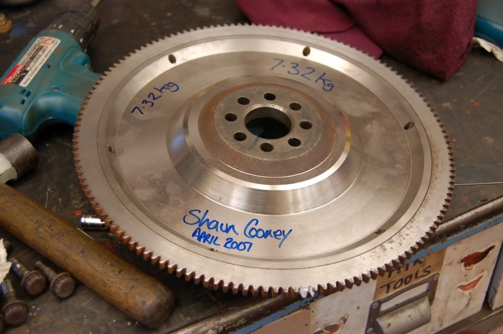

Postby Beans » 29 Mar 2010 20:21
The ridge at the back was removed from this TR7 flywheel, making it approx. 1,5 kg lighter

i can see three ridges, working from the ring gear inwards there's a 2" (ish) flat section, then a slight step up to another flat section around half an inch wide, an incline around maybe 3/4" wide and another 3/4" incline up to the mating face to the crank. Was the metal removed so that the mating face of the crank and all inlcines reduced to be flush with the first 2" section?

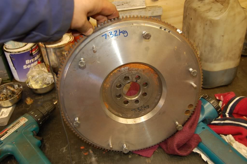

Postby Beans » 31 Mar 2010 18:48
... If so I'll take some pictures tomorrow evening when I'll be working on the car ... <hr height="1" noshade id="quote"></font id="quote"></blockquote id="quote">
Just back from the shed, so as promised ...

No last picture is of a standard TR7 fly wheel,
first picture I posted is of a lightened TR7 fly wheel (minus approx. 1.5 kg).

Lightened flywheel for you:
Shaun
Postby Shauniedawn » 01 Apr 2010 22:28
Makes it look like a standard sprint flywheel. I'll dig one out over the weekend and photograph it next to a standard TR7 one.
Shaun

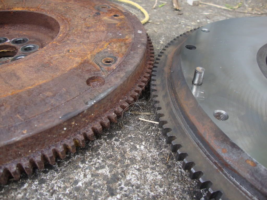

Postby Shauniedawn » 01 Apr 2010 22:31
Someone elses version next to a standard sprint flywheel:
Shaun
