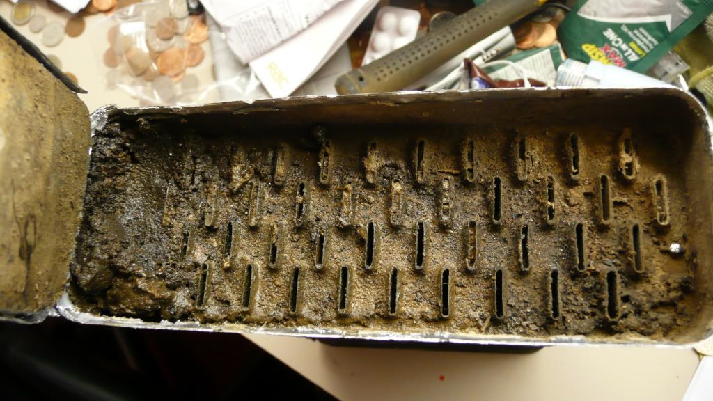

Having built my car from scratch I am very familiar with the dash and within an hour I had the heater box on the bench and the matrix removed. I installed the cleaned matrix but temptation got the better of me and I had to see inside the now removed matrix. Now, bearing in mind the amount of flush I'd ran through it and amount of flushing i had done to it it should of been clean but this is what i saw!
Only a few of the tubes were clear the rest were clogged up and look at the sludge which had settled at the bottom of the tank.
When I installed the dash I just topped up the header tank ran the engine for 5 mins, the coolant light went out straight away (for the first time ever) and topped it up again. I jumped in and could not believe the amount of heat now around my feet. After a ten minute drive I topped up the header one more time and after 3 weeks no more topping up has been required. The coolant light doesn't come on any more. But more importantly as soon as the needle on the temp guage is above the C I get hot not cold air. I cannot begin to explain how its transformed the car and from memory the consensus is many wedges now suffer from poor heaters so I'm sure its common to 2.0L motors as well as V8's. When I drove my Peugeot 406 I used to wish my wedge had a heater as good as that but now its actually better. Today I drove with the roof down whilst the outside temperature was 2C and the heat coming up from the foot wells was wonderful.
Taking the dash out is an awful job but trust me its worth it.
As a footnote for a long time flow tests gave the impression that the matrix was clear but it was misleading. Its now obvious that air in the matrix bleeds automatically in the cooling system so if your heater is less than excellent fit a recon or new matrix and enjoy the heat.

If you don't have much water flow you won't get much cleansing action. That is realy bad. A friend cleaned his Toyota truck rad with CLR and got it working again. Probably not recommended for rads but worked for him. For Those who never heard of it is a calcium, lime, rust cleaner (hence the name). I get the feeling most rad flushes are pretty weak stuff compare to what is sometimes needed.
