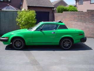

Made the most of the situation and went the whole hog everything stripped, blasted and coated.

Chubster, looking very good, is your car Java Green as it looks brighter than mine, it looks very very nice.

Postby Bobbieslandy » 07 Feb 2010 19:26
I guess that's the only trouble with this website. You set out to do a job only to find someone's done it ten times better and you feel duty bound to match or excell. Man this is going to get expensive!......
Ditto on the colour, looks fantastic.

Postby Chubster » 07 Feb 2010 19:53
Cheers chaps, yes its Java green, it also helps that the sun was shining...Hmmm could do with some sun now!. Its a colour that is either liked or not and have had comments for both. Its also work in progess, each winter it gets another job this year it was rear disk brakes and a watts linkage, however due to the shocks thing its now also a complete suspension build.. oh well..[:p][8]
