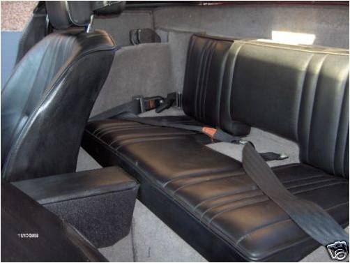

Btw any clue where those rear seats get sourced from?? And any reason for the cut-out in the centre???
Access to the trunk to put your skis in???[:D]

<i>Btw any clue where those rear seats get sourced from?? And any reason for the cut-out in the centre???
Ron.</i>
<font color="green"><font face="Comic Sans MS">If I understand the Q correctly-the grey carpet `cutout` you can see is because the rear seat floor is stepped up in the middle to clear the diff. housing-or rather the bum part of the seat sits lower either side of the diff. so that passengers are sitting lower in the car. The `bench` seat is cutout at the back and disguises this, as does the upright part. [8D]
The seats are bespoke `Grinnal` to do the job and there are at least two styles, one for static seatbelts (straight along the top as first black pic.), and one for inertia reel where the top centre dips lower to allow clearance for the belts that go through to their reel boxes that are mounted centrally below the rear deck panel. The seats were trimmed to match the interior trim. [;)]</font id="Comic Sans MS"></font id="green">
