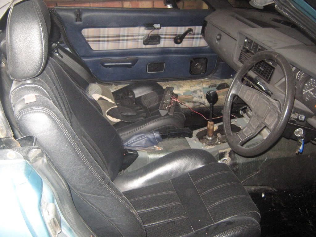

hi all just got my 7 back all moted n mgf seats fitted lovely the garage fitted them nicely an they r low aswell they look as they they belonged in there to begin with[:D] pictues will follow soon[:)]

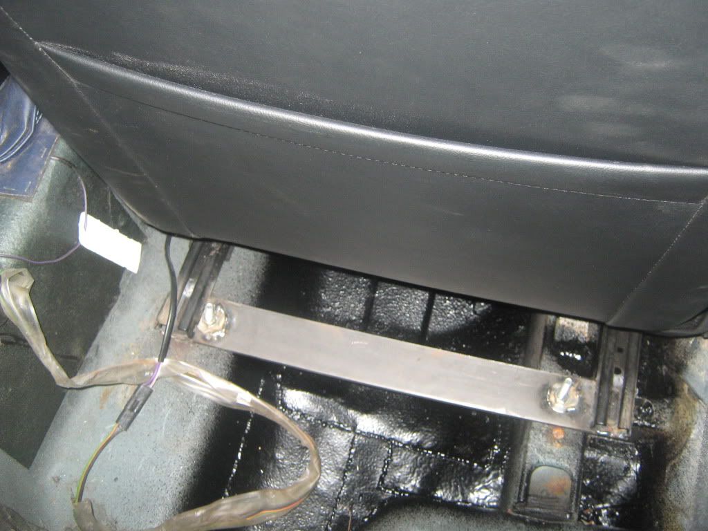

sent shaun a couple of pics of the seats n how they fixed in will send more wen i get her out the garage an looking nice[:D] he will put them on soon cheers shaun[:D]

They look pretty good. Nice side support to stop my skinny butt sliding around & I could do with a back pocket on my seats to file my parking tickets. [:)] Is the height of the front edge the same as the original seat?

pretty much he cut the feet off the back end welded a bar across 4 support left the original 2 front mountings as theyre flat as the front floor dips he used 3 nuts as a spacer so as to level the seat so yes id say level as the original an for me in my own opinion more comfortable than the original seats as i used to get aches in the backs of my legs with theses seats i dont get any[:D]

must mention thanks shaun mate for posting picks [:D]
