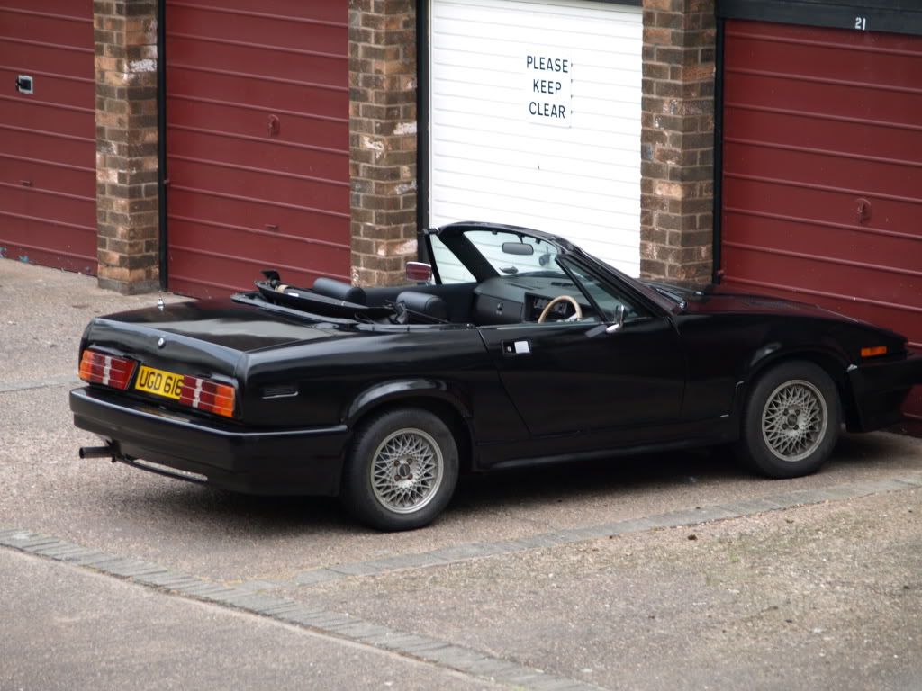

Got another question though, I remembered some Dolomite 13 inch wheels i had. Prob is with the brake conversion on the front they wont fit there, does this happen with MG wheels.
Temp solution is 155/13 steel wheels on rear and 195/60/14 compomotive alloys on the front.
Poor wedge she never really lets me down and i do neglect her and then drive her too hard in the wet and hurt her now she looks sad with mixed wheels so here is a happier pic
Postby busheytrader » 30 Dec 2009 16:45
Ooh! Grinnal style SD1 rear lights.
