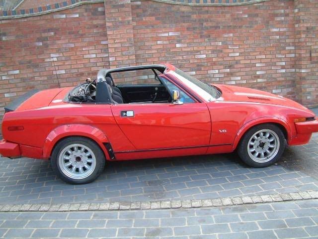

Postby bmcecosse » 10 Dec 2009 17:25
May as well just buy one on ebay - as already suggested! If you are intent on making one - just size it to fit inside the folding roof - I have a slight struggle to get my roof supports up and over mine - but it does fit.

Bmcecosse, If I can buy one for a good price (Gaz, you got one hell of a good deal!) then I will, but they usually state 'pick up only' and live miles away! So I thought 'that will make a good winter project!!' but your right, make it so the roof folds over, that will give me a starting point. What diameter is the tubing on yours ?
