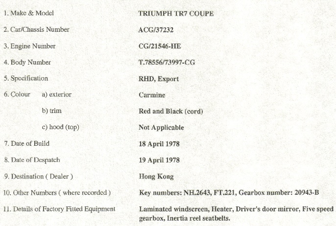

Hello,
This ex Hong Kong car is registered in NZ under its body number. No chassis plate is present anywhere.
The heritage certificate lists two body numbers separated by a /
The number I have on a small silver plate (Not screen printed named plate) is T078556CG
What is the other part of the number on the certificate, the number 73997. Would it be on a plate? Where would that plate be located?
I know of three possible locations for plates with Body numbers
1. Headlight panel gutter under bonnet lip on LHS
2. Under windscreen and plastic dash almost at the windscreen. The flat surface before the metal for the windscreen frame just above the steering column
3. I have seen them on the turret top
I just want to get all the numbers correct on this reshell I am working on. It is more important because the car is registered by body number.
Jolyon

The NEW shell (a 1981 model) also has 81/XXX (x being some number I do not remember) stamped into the A Pillar near the hinges and the same number stamped into the door internal panel. I will drill a hole through the ones on the A pillar for the alarm door switches and the doors do not matter. (Yes doors have the later locks but I can fix that.)
So really, I just do not understand the Heritage certificate number.
Why the "/" through the number? Are there possibly two different numbers on a shell?
Jolyon

Jolyon, I am not 100% sure about this but I believe that the body shells may have had two body numbers;
One number for the unpainted/untrimmed shell, then a second number for the shell after painting/trimming. Don't ask why - another BL foible!
I believe that the number usually used to ID the body is the trimmed body number.

Trimmed and untrimmed, that sounds logical. I had another car that had two numbers and I thought this meant it was a reshell.
With this amunition I will approach Heritage to ask.
Does anyone know which number goes under the Bonnet hinge area in the headlight panel gutter?? (My guess is untrimmed as this is partly hidden once they fit the bonnet (hood to Americans).

Apparently the way to tell which number is which is that the untrimmed/unpainted number will have been sprayed over when the shell was trimmed/painted, so the tag should be in the body colour.
The second number should have been affixed after painting.
TR8 FHC EFI Factory development car</font id="size1">

Of course!!!
The one in the headlight panel gutter, under thebonnet leading edge, is alsways painted over.
So - untrimmed number on heallight panel or on metal above dasboar
Trimmed number on Turret
