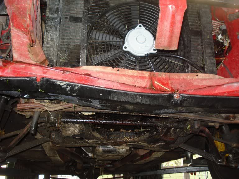

Did you damaged spoiler/valance look anything like this!
