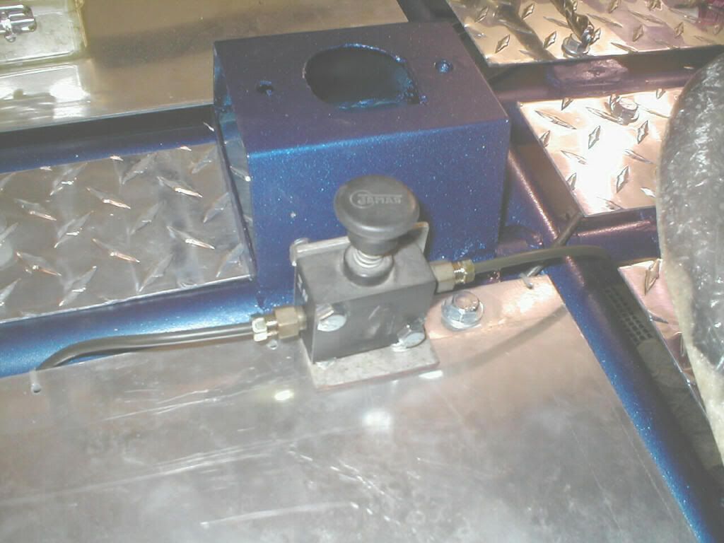

Postby Bill » 30 Apr 2009 13:58
<b>Has anyone considered an inline hydraulic lock (like we used on our dunebuggy) for a parking brake?</b>http://www.jamarperformance.com/Store/Details.asp?ProductID=31
Bill
1980 Persian Aqua DHCImage
Postby Hasbeen » 30 Apr 2009 14:57
Yes. They are not legal in my state.

They are not legal in my state.<hr height="1" noshade id="quote"></font id="quote"></blockquote id="quote">
Nor in the UK, but a bolt locking the propshaft would be... [:p]
