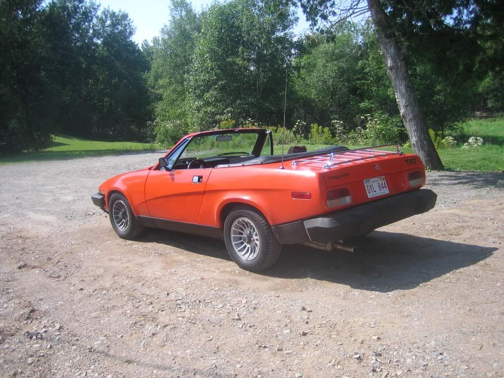

trying to get pic on site so u can see my baby think i have on home page trying hereImage
