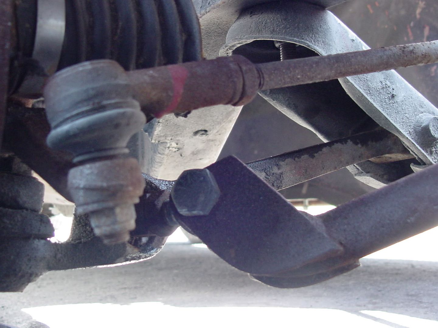

I like the anti-roll bar and diagonal links of the Group 44 setup.
But the issue with it is that in using the original track control arm they have stuck with the original TCA inner bushing (CRC307).
If a rose joint is used on the inner end of the TCA we can have caster adjustment, and this is what I like about the TRS unit:

Postby Beans » 29 Dec 2008 11:05
<blockquote id="quote"><font size="1" face="Century Gothic, Verdana, Arial, Helvetica" id="quote">quote:<hr height="1" noshade id="quote"><i>Originally posted by omichaelshar</i>
... But the issue with it is that in using the original track control arm they have stuck with the original TCA inner bushing (CRC307) ...
... If a rose joint is used on the inner end of the TCA we can have caster adjustment ...<hr height="1" noshade id="quote"></font id="quote"></blockquote id="quote">
Or adapt the original TCA so you can adjust it and use rose joints ...
Make sure you use a welder who knows how to weld cast iron/steel though.
Fitting adjustable TCA's on my car (combined with a decent geometry check) still rates as one of the best suspension mod's I carried out on the car.

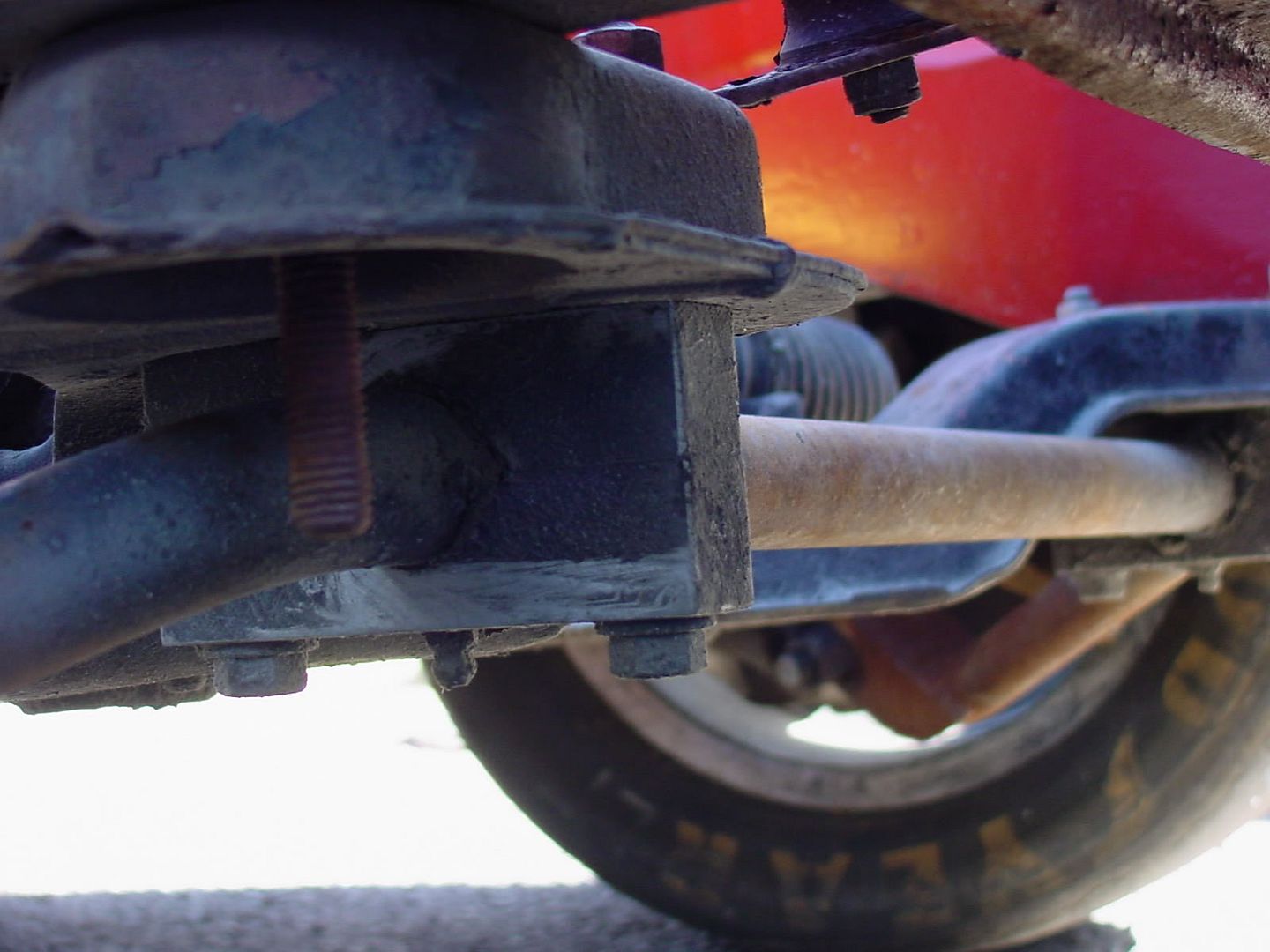

Postby tr8 » 29 Dec 2008 13:10
I like that mod too, very simple and effective. My race car has a rose joint in the end of the oversized sway bar that was fitted. Also has a grease fitting where the bushing normally goes.

Or adapt the original TCA so you can adjust it and use rose joints ... Fitting adjustable TCA's on my car (combined with a decent geometry check) still rates as one of the best suspension mod's I carried out on the car.
Bean's you are full of surprises. I assume you made this mod to obtain adjustable camber rather than fitting one of the strut top units. Or is there some other benefit to be obtained? Have you also used a rose joint to replace the inner TCA bush? If so, did it make the ride much harsher?
Did your geometry check reveal any discrepancy in caster between left and right? If so, how are you adjusting it?
<blockquote id="quote"><font size="1" face="Century Gothic, Verdana, Arial, Helvetica" id="quote">quote:<hr height="1" noshade id="quote"><i>Originally posted by tr8</i>
... My race car has a rose joint in the end of the oversized sway bar that was fitted. Also has a grease fitting where the bushing normally goes.
Paul, that looks like an interesting setup. Any chance of some more pics?

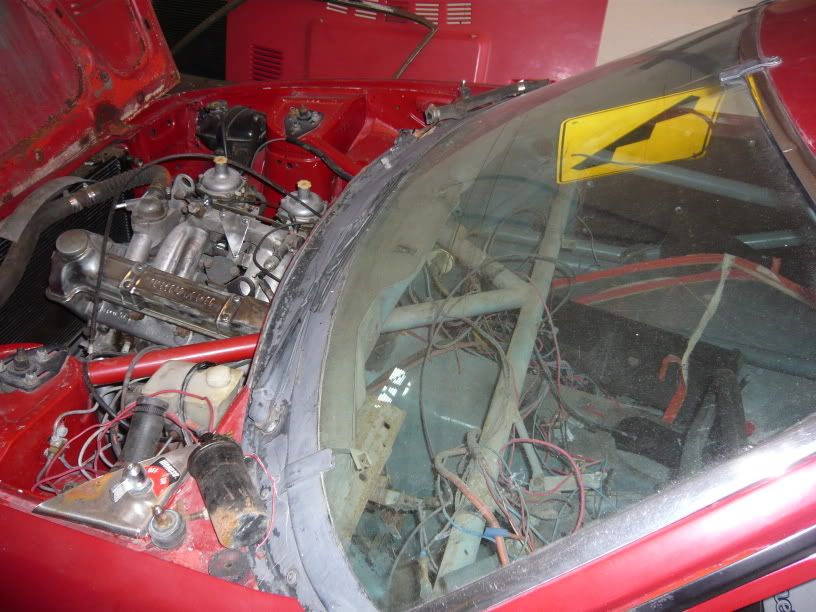

Postby tr8 » 29 Dec 2008 21:26
Here is another couple of pictures of the front end of the race car. It has coil overs on the front with adjustable spring perches and adjustable camber plates on top.... also has a pretty good strut brace which is tubing connected to the roll cage.

Postby omichaelshar » 29 Dec 2008 21:43
Wow! I haven't seen anything like that before. Paul, what does the rest of the roll cage look like? Do you know the history of this car?

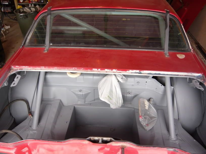

Postby tr8 » 29 Dec 2008 22:06
Here is a shot of the trunk/boot area full fuel cell and in the drivers area full cage with diagonal brace acorss where a passenger would sit. It was built from a 1975 car, number ACL512 by a BL dealer. Talked extensively with him. He said a lot of BL racing stuff on the car as he could get it cheap/free. I fell in love with the car just looking at all the modifications. Used to run a fully balanced 8V 4 cylinder with weber side drafts. Close ratio 5 speed. One piece front bumber and spoiler made of light wieght fiberglas, the whole unit wieghs about 10 pounds.
Postby Beans » 03 Jan 2009 23:56
... I assume you made this mod to obtain adjustable camber rather than fitting one of the strut top units. Or is there some other benefit to be obtained? Have you also used a rose joint to replace the inner TCA bush? If so, did it make the ride much harsher?
Did your geometry check reveal any discrepancy in caster between left and right? If so, how are you adjusting it?<hr height="1" noshade id="quote"></font id="quote"></blockquote id="quote">
Indeed put them under the car to get the camber adjusted properly at -2º which suits my set up and driving best. There was a difference between left and right of 1º if I rememeber correctly. Made a huge difference in handling [:)]
Adjusted the castor angle with shims between ARB and front of TCA.
Inner bushes are indeed replaced with spherical bearings. Only on cobblestones does the ride become harsh. In all other situations it just handles much sharper [:D]
