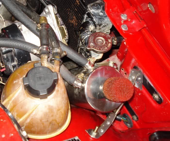

This was all in the name of curing this overheating problem. Someone suggested that the old fan with its fat 4 blades was not the best so I put the new fan on using all the existing wiring. I also piped the overflow spout from the radiator to the header tank which has what looks like a pressure relief valve. But when the fan stopped working I found out that the valve doesn't work so instead of relieving itself from the spout the water just came out from the radiator cap in a fairly dramatic fashion. The plastic header tank is from a Holden I believe. I've disconnected the spout hose from the tank for now but surely the header tank cap should blow off pressure before the radiator cap does.

I'm ahead of you there, Mildred. I borrowed a temp gun on Friday & found that the radiator was working well. My problem seems to be that the expansion tank cap does not release pressure so the pressure builds up in the radiator until it escapes through the rad cap.

A bit of confusion, are you saying the radiator cap is not releasing pressure at the indicated amount on the label?
Back in the old days, we used to replace radiator caps all the time.
Postby Cobber » 31 Jan 2009 22:34
<font face="Comic Sans MS"><font size="2">Does the radiator cap have the correct pressure rating?
Is it's pressure rating less than that of the header tank cap? If so that would explain why it releases first.
Is your cooling system over pressurising because of another reason? Maybe a stuffed thermostat or worse a blown head gasket or cracked head?
First just replace the radiator cap they're cheap, while ya at it ya may as well replace the thermostat too!
Then you need to establish that your not getting combustion gases leaking into the cooling system. I suggest you do both a compression test and a radiator pressure test at the same time.</font id="size2"></font id="Comic Sans MS">
