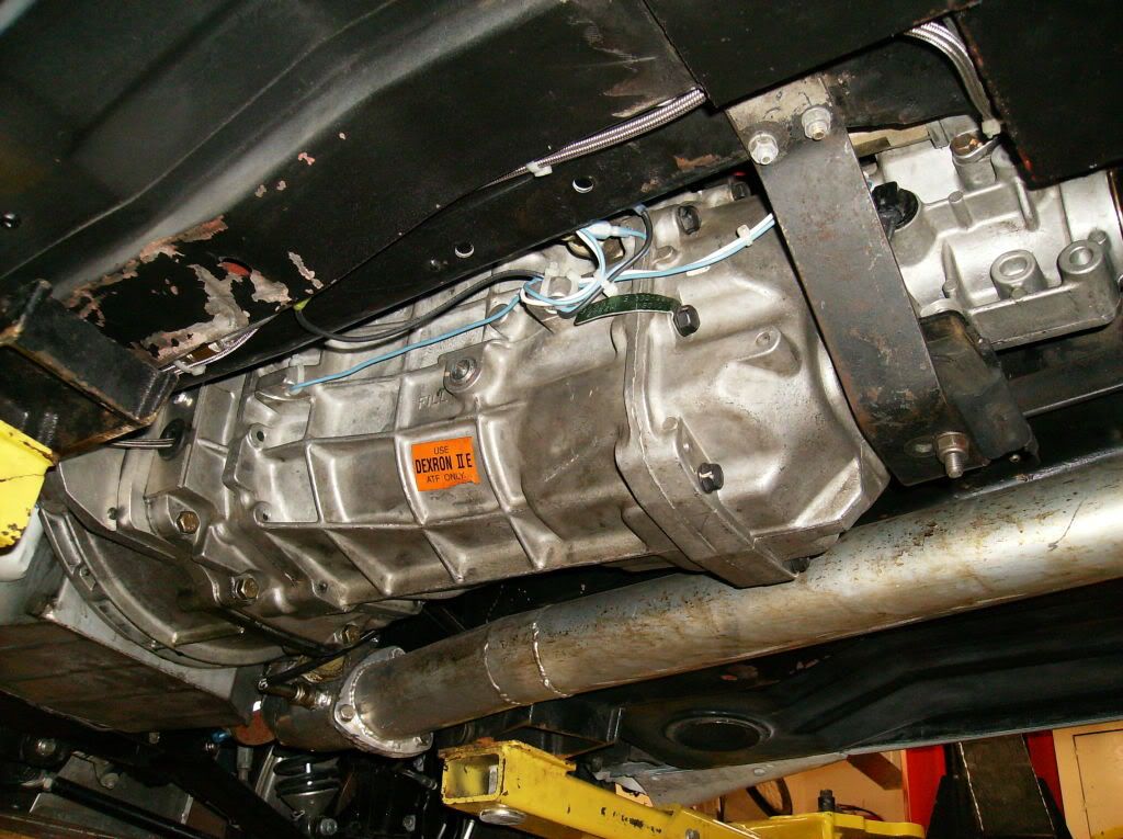

Ah quite a familiar debate. Same thing happens on the MG forum when I state I have been running ATF in my MGB OD for well over 15 yrs. ATF in manual transmissions is nothing peculiar to BL and the LT77. Chrysler & GM recomended it for a 4spd OD box I once had. An interesting photo posted recently.
This car has a 383 SB Chevy with twin turbos. I'd venture to say a bit more power than a TR7 or even a Rover V8.[;)]
Having said that, I have been useing GM syncro in mine. I just call my dealer and have a couple bottles delived at my discounted price. I did previously run ATF and wouldn't hesitate to again if the GM stuff gets hard to get.

Postby Workshop Help » 04 Apr 2010 14:05
Beat the dead horse. Beat the dead horse.
Yes, my friends, and the above modern transmission was specifically designed for ATF lubrication. Ours were not. The BL/JRT boys jumped on ATF as a quick and cheap fix for the cold start shifting problems of the LT77. However, the LT77 was designed with tolerances designed for a thicker oil when at it's hot operating temperature. And, it was designed for a very wide range of applications, from 2500 pound sportscars to multi ton commercial and military vehicles with a maximum output of 300 flywheel horsepower. As such, with it's greater tolerances than now seen in modern gearboxes, the mixture that is a modern MTF now allows a more acceptable first-second gear shift when cold while providing the proper cushioning effect and lubrication of the gearbox internals when hot. Which was what was needed back in the 1970's when the LT77 was being designed.

I don't know but believe it is my fault posting the photo. Sorry. Photobucket has somehow changed the size of what they call "full size" from what it once was. Why can't things be left alone?
Also FWIW, I am absolutely sure that automatic transmissions operate at a much higher temerature than any manual every made in history. Multiple clutch assmeblys, small planetary gear sets and not to mention the heat created by the torque converter. They all have some sort of cooler to help cope with the heat generated. I am at a loss as to how ATF somehow loses its lubricating properties as is warms up in a manual trans.
