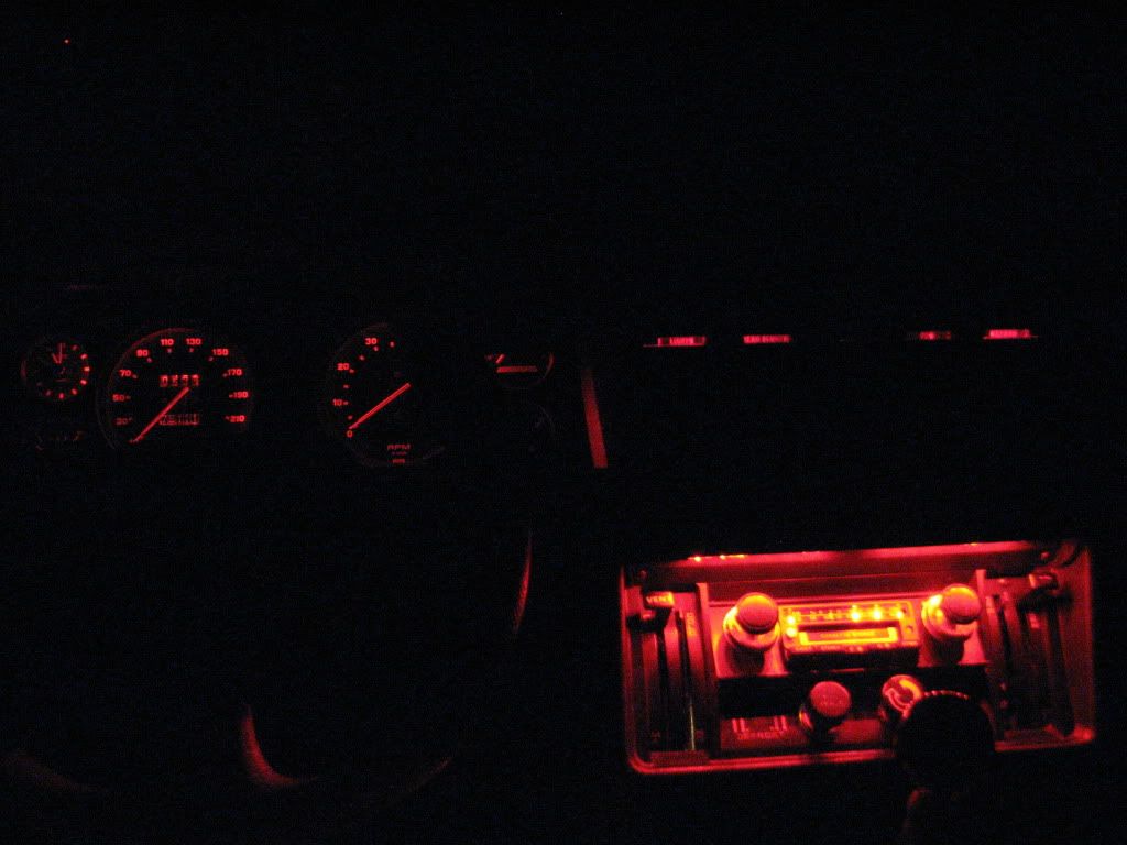

Postby Bendder » 14 Oct 2011 13:04
Randy
I actualy got them at Walmart Both the ones for above the radio and the single bulbs that I used for the switch lights. The switch light needed to have the small 90degree clip removed and I ground the plastic ligh stip straight because the light from the led comed from the end of the bulb and not the side I used some shrink wrap slipped over the end of the plastic light bar andthe bulb to hols them in place. The ones above the radio were the small 4" strips but like Stevie says they are a bit bright and I have since cut them shorter and eliminated some of the lights. Have had them in for two summers so far and mo problems. I also used them in the door lights. I used red led's everywhere for a matched look and it goes well with the red carpet and red check seats.

Postby Bendder » 14 Oct 2011 18:11
I just stuck them under the panel and I removed the small green lens from the original lights and used the hole to run the wires through. You can not see them unless you are down at the seat cusion level.
