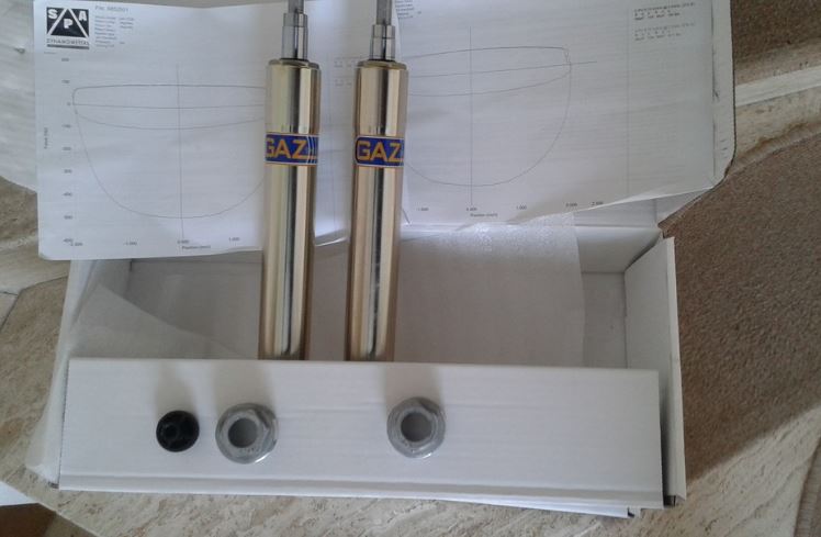

Hi All
The red Koni are incredible ! I had this in my first TR7 (White with blue sides strips)
A horde Super 7 and I drove to the South Tyrol over Stilfserjoch ( Beans know where)
All Seven Pilot came to me - You are sticking on the asphalt! :lol: But I did not find the red ones anymore are gone with the car but...
I hope I made a good decision :roll: I've got it from Dampertech LTD UK ask Dave a nice Guy
