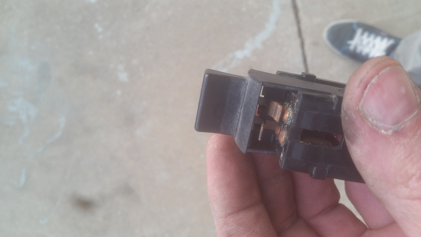

Well I went ahead today and recleaned the grounds I did earlier with contact cleaner and did a bunch of other connections with said contact cleaner and dielectric grease. Then I moved onto the headlight switch. It seemed okay to tell you the truth. Very very little green oxidization and even then it was at the base of only one contact in the switch. The actually spots where the electrical connections are made were clean and copper coloured. I sprayed them anyways and applied some grease.
Is it normal for the switch to be so difficult to return to the upper position? Mine seems to not want to go there. I can force it there, and there wasn't anything stopping it from going to that upper position but it really doesn't want to do it. I greased the tracks where the little white pegs ride and that did something, not much but something. It just feels like I'm gonna break the thing.

So here is what the switch looked like before cleaning. Not too shabby eh?
I'll check out the other switches and wires because there seems to be something screwy going on back there. Looks to me like a quick fix gone wrong (for me). I am guessing that there weren't two sets of (distribution?) blocks wired in directly behind the hazard and fog light switches by the factory. You know those blocks with little bars with flat head screws on either end? I wish I took a picture of it, but my phone died. Either way its a joke question anyway because every wire coming off of that block to the switches are done in black. That's not factory for sure. Also they were soldered and I bet ya Hasbeen is right and even if they were initially hooked up correctly the wires are probably corroded to hell.

Mine were much worse. I took mine apart and cleaned them with Brasso. They became a bright copper colour like the day they were punched out of the copper plate. Dielectric grease will help them stay that way. Repeat with every connection. 9 years of trouble free electrics. Well almost. I replaced a dodgy Delco brake light switch (at brake pedal) for a trouble free Lucas one out of my (other) older TR7. Oh, and a starter issue that ultimately boiled down to the positive battery cable clamp to battery wire connection were the lead in the clamp was deformed enough so it couldn't grab the cable tight enough. Discovered that one by accident. Wish my Acura was as reliable electrically (they have weak capacitors in the ICU that burn out and cause a myriad of glitches in the accessories).
