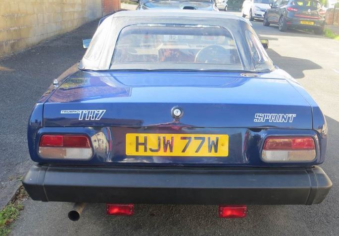

I think they were mostly all fitted with rear fog lights by the time yours was built, but if in doubt, rather than have a debate with the MOT tester why not fit them yourself. Its easy to do and the wiring is all there in the boot ready to go. There are even captive nuts in the bumper. The brackets are pretty simple "L" shaped so you can easy make something if you don't have any them. You only need one for the test but I think they look better with two.
Triumph TR7 Rear Fog Light Brackets.JPG (50.91 KiB) Viewed 5736 times
