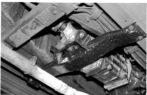

HI, thanks for the replies. Trying to adapt this arrangement to a std mount.
LT77 gearbox mount.jpg (155.37 KiB) Viewed 4090 times

Postby sonscar » 27 Mar 2016 08:54
Good old MGB mount.I have the same thing on my MG and it is very good,worth copying.Steve..
