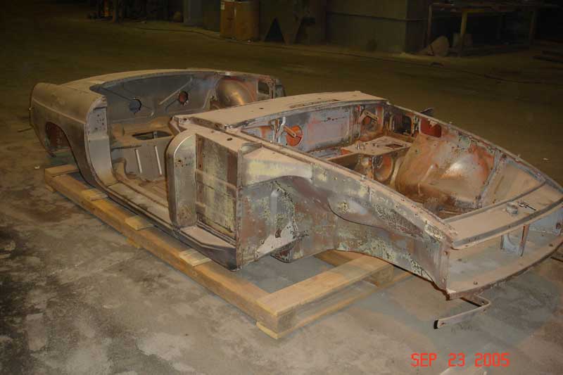

Postby Underdog » 18 Mar 2010 15:09
My B once looked like that Tim. Looks to be a nice tub.
Here it is now.
Jim Underwood
mb4tim
Posts: 1236
Joined: 27 Aug 2006 13:46
Postby mb4tim » 18 Mar 2010 17:19
Jim, that's with the new steel already in. The bad stuff was easy to spot before it went to the media blaster on Neville Island.
-Tim
