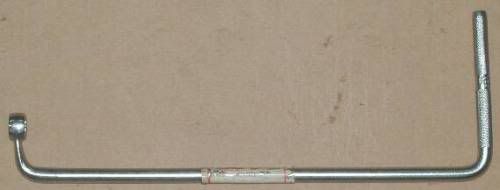

Postby john 215 » 30 Apr 2012 18:32
Need one of these -

It is just about possible with the ring end of a normal spanner but I got an S shaped one a bit like the one Beans shows above - 11mm I think from memory - did the trick and was easy once I found the route in. No need to remove anything but the dizzy cap and airbox if you have one.

Postby mitchelltjohn » 01 May 2012 07:44
yes John215 , that's it!
Is this the official BL workshop tool, or did you make yourself?

Postby Workshop Help » 01 May 2012 12:19
I recall my late father had one of those bent around wrenches to get to the hold down clamp bolt on his 1962 Ford Falcon 6-cylinder. Or, was it on the 1957 Plymouth? I thought it might still be out there in the machine shed, but I couldn't find it.
This wrench is/was a very common accessory wrench found most everywhere at one time. Most were in 1/2" configuration.

Postby dursleyman » 01 May 2012 15:33
I found one of those official tools on Ebay, and even then its not easy to get around the distributor body.
