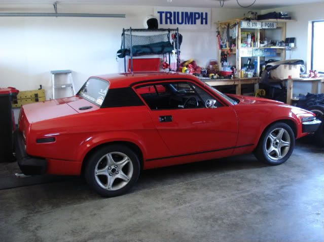

Postby PeterTR7V8 » 22 Feb 2010 00:29
If it's the right thread & the right shape then it's the right nut. I had always thought that wheel nuts where more specific to the wheel rather than the car brand.
Just make sure you have enough thread holding the wheel on & that the nuts hold the wheel against the hub correctly. The MGF wheels I use that requires a shanked nut otherwise the depth of the thread used is less than the diameter of the stud which I'm told is the minimum rule.

Postby Jolyon39 » 22 Feb 2010 09:31
Hey Peter.... your new garage looks great!!
