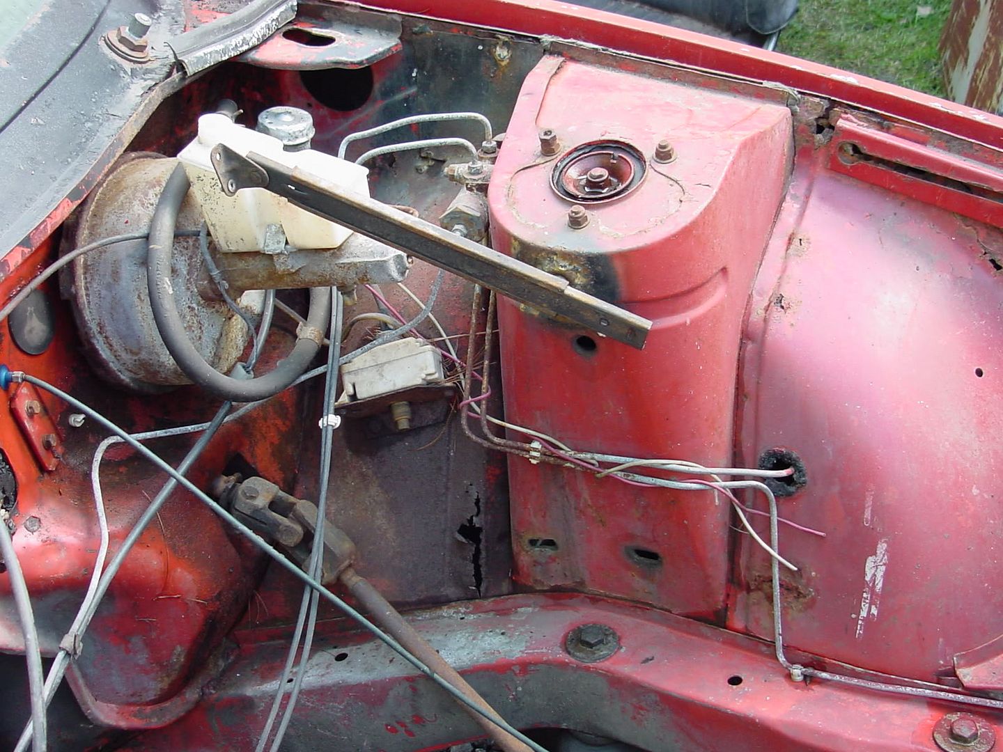

Postby tr8 » 09 Feb 2009 01:15
I've seen the two part cable on TR7 parts cars that I've had. Definitely not FI cars.
Postby tr8 » 09 Feb 2009 01:21
Here is a picture of one of them, a 1975, you can also see the very early prop rod for the hood/bonnet.
